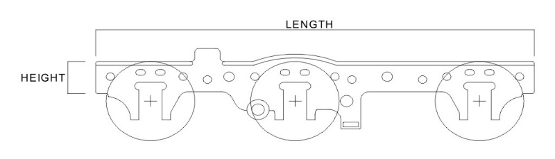

I am drawing up the Commonwealth trucks used on Baldwin DRS-6-6-1500, AS-616, and early Fairbanks Morris H16-66 locomotives for use on a 1/8 scale locomotive.
I am looking for drawings or photographs of un-mounted trucks. Or if someone is close to one of the serving Baldwin’s a couple of measurements would be a great help. The length and height of the side frame would get me in the right ballpark. I have the axle spacing.
The size of the holes in the side frame would be an added bonus.
Thanks for any help:
Tim Meyer

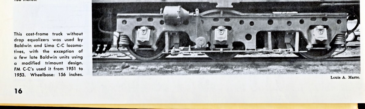

I did find a photo for you , it is out of The Second Diesels Spotter's Guide put out by Kalmbach Books . Pat.
File comment: From Diesel's Spotter's Guide
