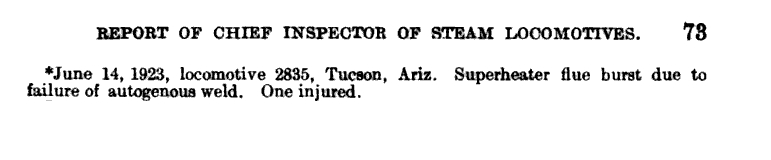

Example of weld failure on the SP in Tucson:

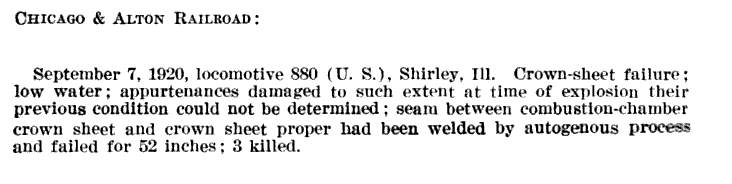

Example of weld failure on the C&A:
