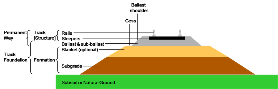

Hi folks. Would anyone have both postwar era & present day info on the typical cross section of street running trackage for trolley or streetcar equipment? Mostly how the track is laid under the streets, and the brick or concrete surrounding roadway surface. It can be specific to a particular line or region (i.e. Toronto), as it is for a general overview.
Needed for a simple presentation.
Thanks!
Chris
cscardinal AT live.com

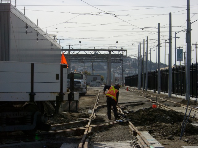

Hi
You might look at the APTA (American Passenger Transport Ass.) web site, there maybe some information there you could use for your presentation, or look at old Electric Railway Journels, ect... the info is out there.
Karl Johnson
File comment: MUNI rail project at the MUNI Metro East shop and yard site; Feb 2008
