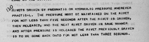

First is a BLW riveting spec for PRR K-4 boiler. Seems to be written in legalese.

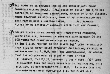

Second is riveting spec for MLW 4-6-4 boiler.

What is the reason for going back onto the rivet previously driven?
