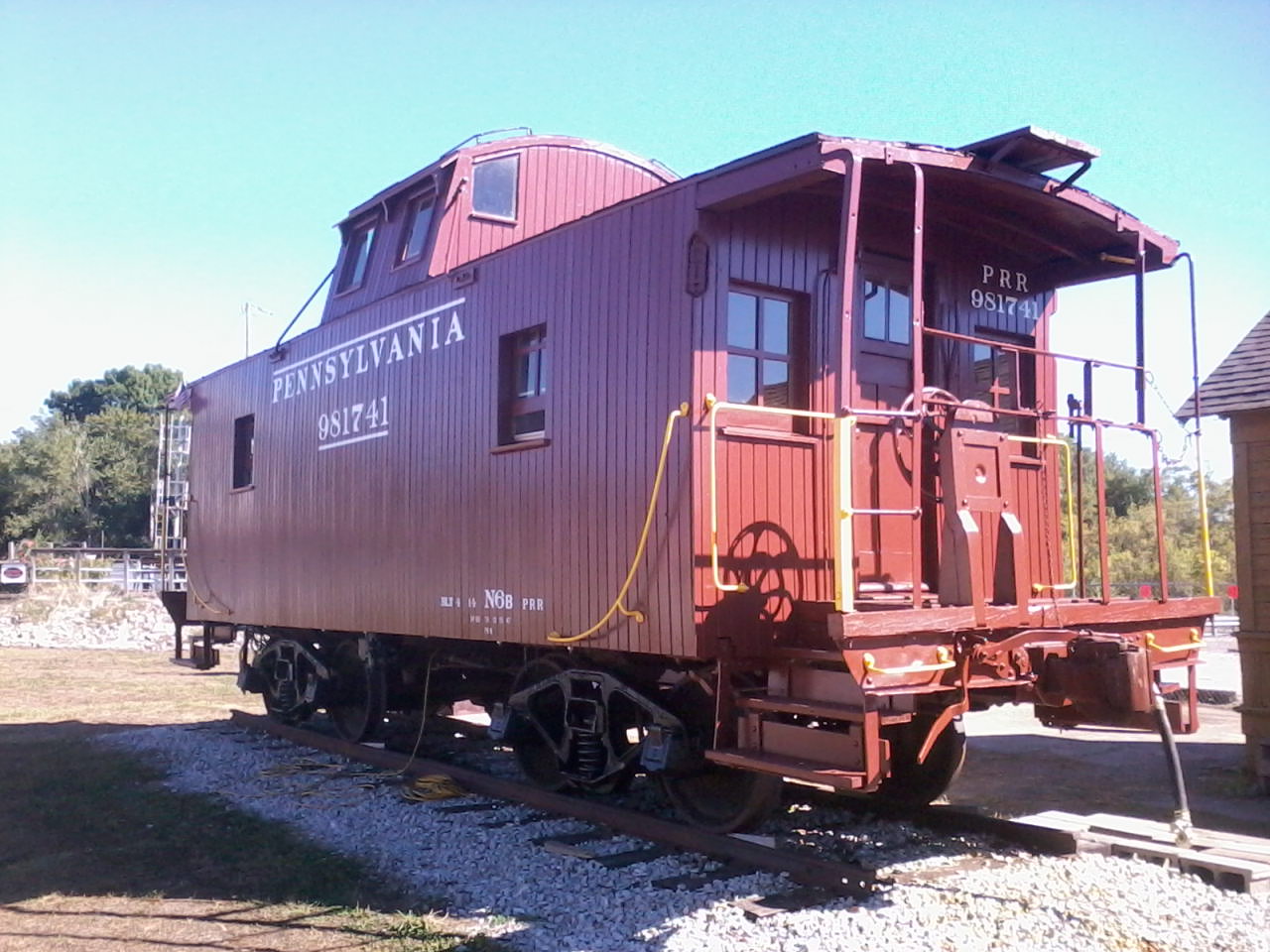

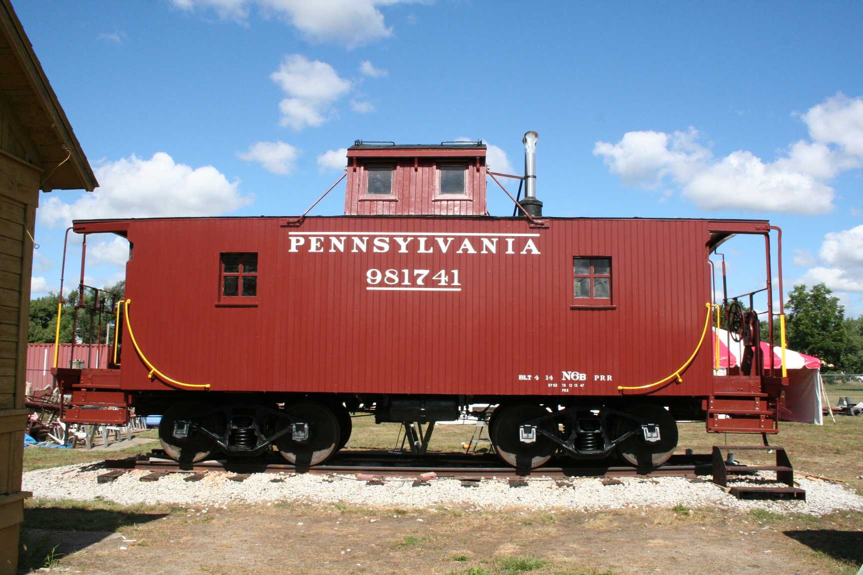

Our N6b is done. Terre Haute Mayor Duke Bennett assisted us with a ribbon cutting ceremony today.
Side view is before I installed marker brackets.

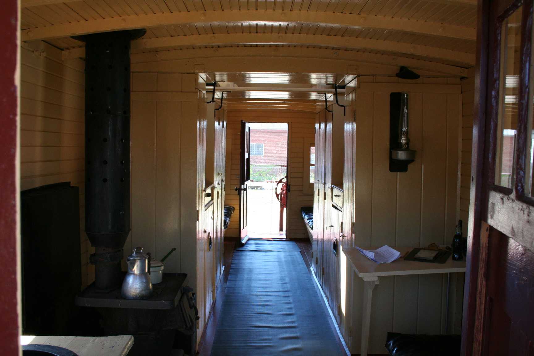

We kept what I call cosmetic items like closet doors, but everything else was replaced or rebuilt including the end doors.
Bill Foster
Haley Tower Historical & Technical Society
www.haleytower.org

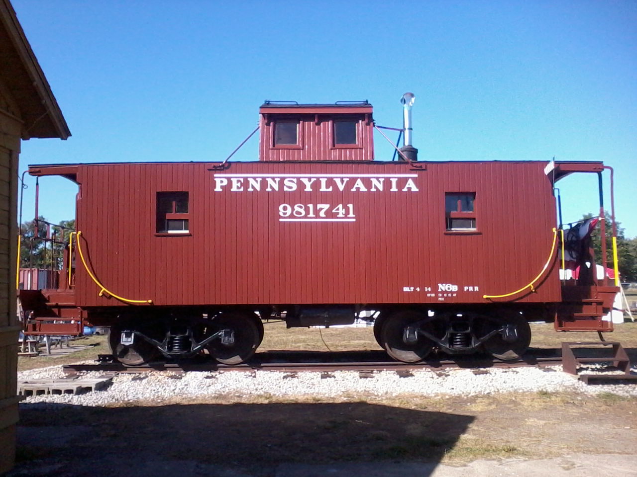

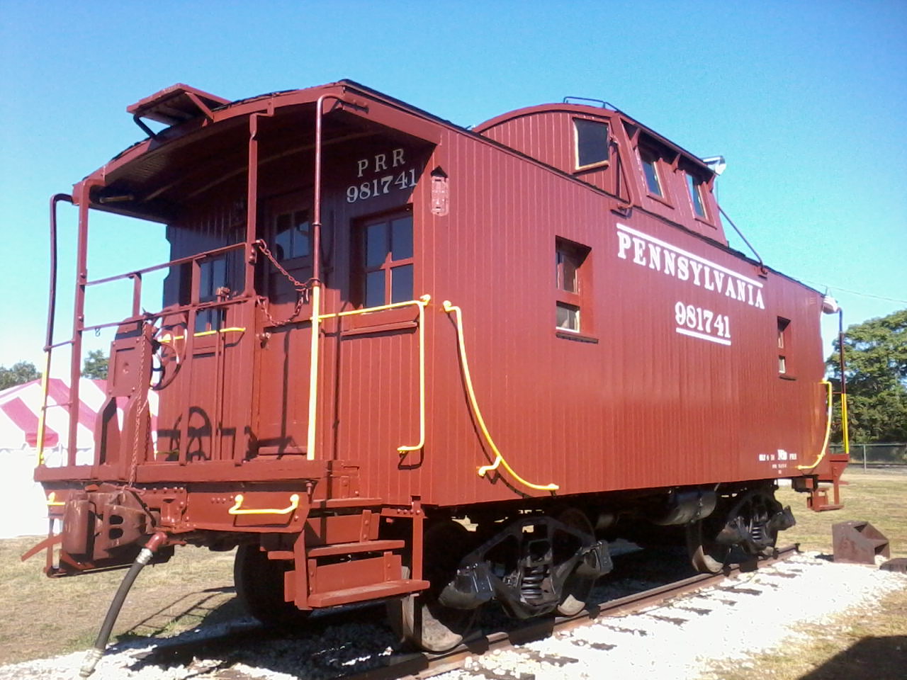

Posts: 211
Thanks for all the kudos. I will pass them along.
It's been a long 5 year project.
Here's a couple more views via my cell camera. Not the best quality.
There are also some restoration pics on our facebook page. Search wabash valley railroaders museum.
Also, if anybody needs some of the marker holders/brackets we have a source who made some replicas to replace what was stolen from our car. The only thing missing is the casting numbers. We may be able to get additional brackets made.
Bill

Just out of curiosity, what is the roof covering? It looks odd, with no tack molding, but hey, what do i know about the Pennsy?

Dennis Storzek wrote:
Looks really nice.
Asphalt roll roofing with a standard aluminum drip edge. We looked at rubber and a few other techniques and decided to go this route because the roof surface is not smooth. The catch is there are no nails. The achille's heel of these cars has always been the sloped cupola and roof around it. So, we've used some modern techniques to keep the water out.
Also, the blocks holding the cupola brackets are to help keep from crushing the drip edge and siding when tightening the bolts.
Bill
