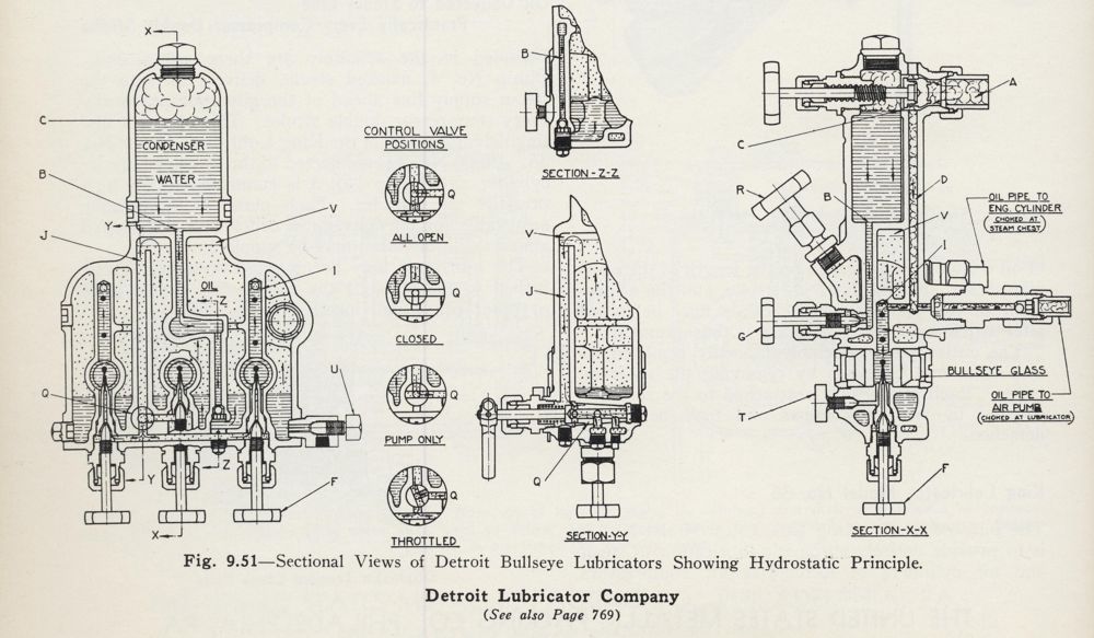

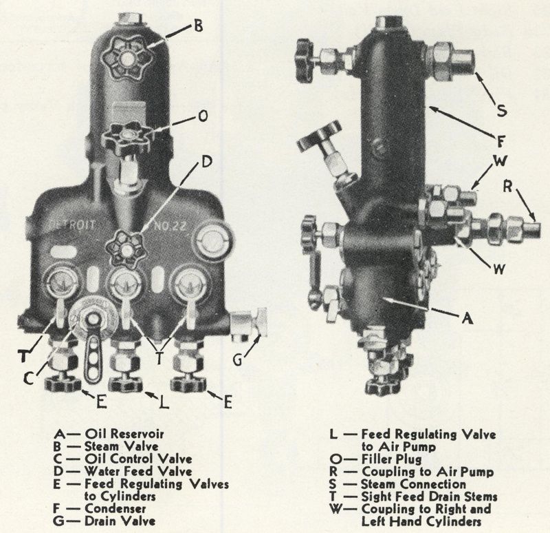

Here is the procedure I recommend.
There are four or, depending on the lubricator, five valves involved in the process.
1. Steam supply valve. Controls the steam supply to the lubricator.
2. Water valve. Controls flow from the condensing bulb to the oil reservoir.
3. Oil valve. (if equipped) Controls communication from the oil reservoir to two or more of the regulating valves. On multi-feed lubricators this valve allows the oil supply to be closed off to the feeds supplying the valves and cylinders without having to reset the feed rate when stopping for extended periods. The feed supplying the air compressor is normally not affected by this valve and is always in communication with the oil reservoir.
4. Regulating valves. Controls the oil flow to each individual feed.
5. Oil reservoir drain valve.
I have seen engines with a valve on the oil delivery line, but that is a bit unusual.
To successfully and safely refill a lubricator the oil reservoir must be completely isolated from any source of pressure. I suspect that some have problems on lubricators equipped with oil valves (#3) because they do not realize that not all of the feeds are supplied through them. If the air compressor feed is connected directly to the oil reservoir and the regulating valve for it is not closed, steam will back up through this valve into the oil reservoir even when the oil valve is closed. This is why I recommend closing all the regulating valves when refilling.
To shut down and refill a lubricator: In this order, close valves 4, 3, 2, and 1. Open the drain valve, 5 and leave it open until all the pressure is relieved in the oil reservoir and it is drained as much as possible. Then, and only then, slowly open the fill plug. The fill plug should have a telltale hole drilled about half way up the threaded portion to alert you if there is still pressure in the reservoir before the plug is completely removed.
After the fill plug is removed and all the water is drained from the oil reservoir, close the drain valve, 5, and refill the oil reservoir with your favorite valve oil. Reinstall and tighten the fill plug. If the gasket is in good condition on the fill plug it should not require excessive tightening.
To restart the lubricator, open the valves in this order: Steam valve, 1. Allow the sight glasses to refill before proceeding. Then open valve 2, and 3. Adjust the regulating valve(s) for the proper feed.
This process, particularly when restarting, must be followed exatcly or you will have problems getting the lubricator to work correctly.
 Post subject: Re: Hydrostatic Lubricators and Safety
PostPosted: Sun Oct 05, 2014 10:41 pm
Posts: 1121
Location: Warszawa, Polska
Russ, thanks for the explanation.
It never registered before that the steam supply from the appliances that the lubricator lubricates can definitely flow backwards through the lubricating lines, and on 6167 (which has a 3-feed Detroit lubricator) I don't think there are any intermediate valves on the lubricator lines to the Air Pump, Water Pump and Stoker. So thanks for that too!

Thanks for all the stories and explanations. I would never want to try an re fill one on the run! But I guess if you absolutely have to...... Personally I always filled them first thing in the morning when there was only 20-50 psi on the boiler, I only did it a few times at working pressure. Nice illustration Joe.
