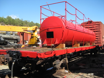

Pacific Locomotive Association has used POR15 to coat the interior of two tank cars (for water service), one locomotive tender, a saddle tank, and pair of side tanks. We are very satisfied with the POR15 product, our two oldest tanks were coated over 20 years ago and the coating is still holding up very well. We plan on coating the interior of our newest acquisition in the next couple months.
Johnathon Kruger
Road Foreman of Engines
Niles Canyon Railway
File comment: McCould Railway fire car #1711. Brightside, CA; 8/31/13
