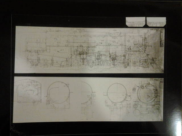

I own an erection card drawing from the American Locomotive Works and I recently came across the problem of not having an idea what size it was. I read somewhere a while back that Lima drawings were made to 1 1/2 inch scale. Did Alco follow this process? The Drawing has the date issued as being April, 12th 1926. Also, what would the dimensions of the sheet be? I see z filling a small table at the top of the sheet but I cannot read the table at the bottom of the sheet. I am guessing that this is the size of the sheet since I cant see any sheet size possibilities anywhere else.

Great information RCW! It is nice to know this now, who knows how much it could help one in the future! My drawings have the following number: 420 S 33220. I am not so sure that the S stands for Schenectady though, as the locomotive in the drawings was built at the Richmond locomotive works. Maybe it stands for where the drawing was made?
File comment: sorry about the quality of the picture
