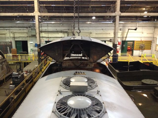

File comment: Gardner Denver air cooled 3-cyl compressor on the overhead crane
File comment: Removing the dynamic brake hatch over the compressor.
