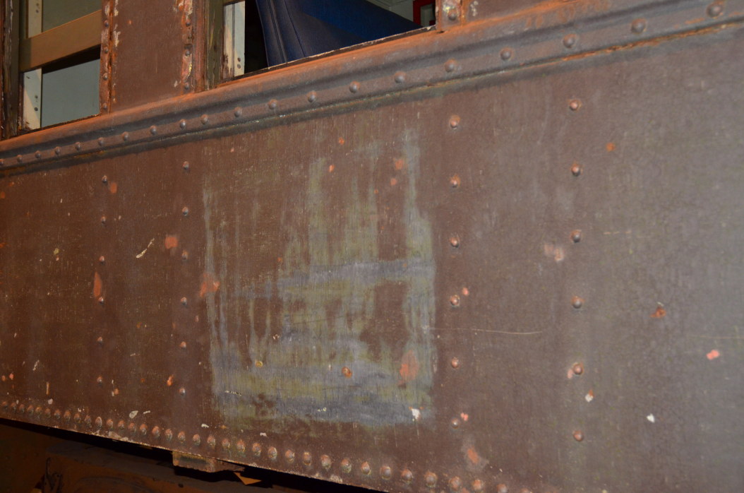

During the process, the 1937 "tilted wafer" CN monogram was revealed, and that made the decision to use the 1937-45 paint and lettering scheme. There were a very few photos in books to work from, for an overall layout and placement of the letters and stripes. A drawing of the monogram was purchased from Strasburg Rail Road and was modified/tweaked by RMNE's Tony Pratt and this correspondent. Paint used was S-W enamel, based on color samples provided a few years ago by Kent Mc Clure of Monticello Railroad Museum.

Ghost of the Tilted Wafer revealed!!

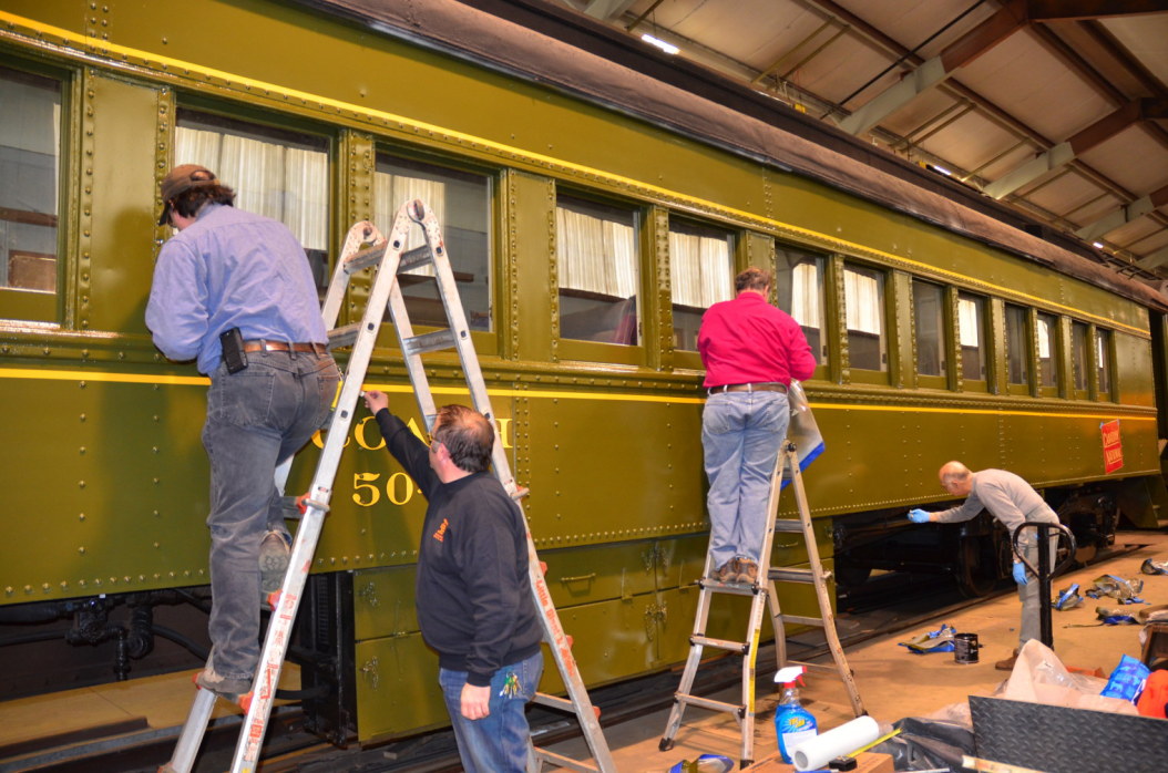

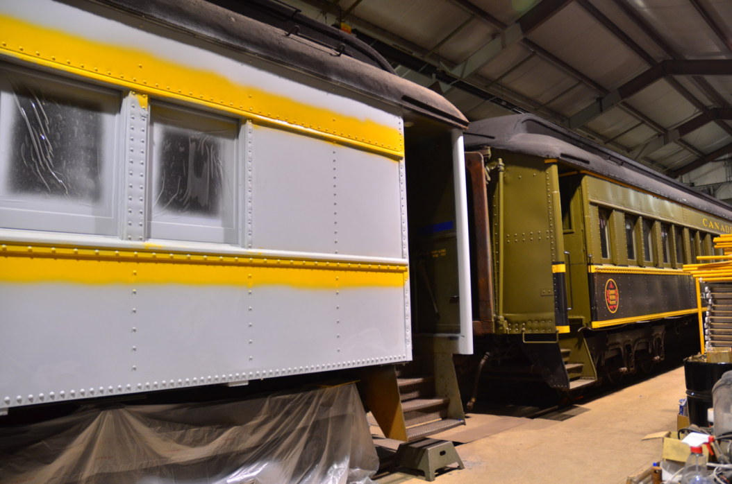

5046 on left, CNR 5114 on right, inside for dressing with lights and decorations. 5114 was painted about 12 months ago.
RMNE Shop Elves removing masking, etc. L to R: Lee Van Idersteen, Dave Manning, John Springer and Kurt Viener.
This is really a striking, elegant yet understated painting and lettering style. A couple more photos will follow.

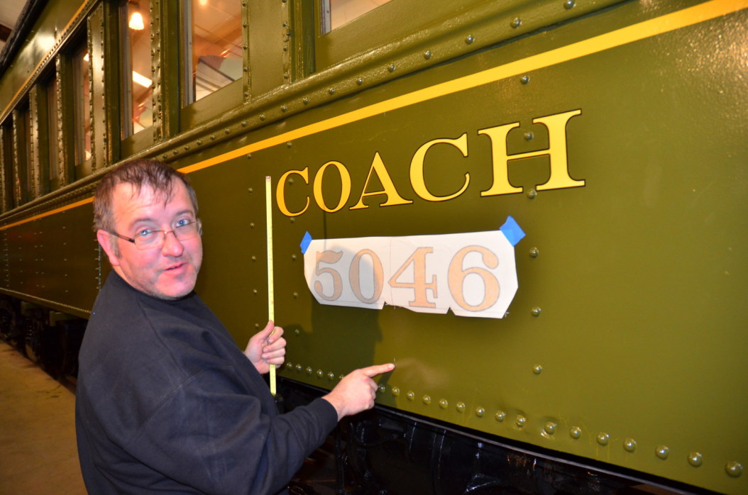

Dave Manning applying lettering to west side of car.

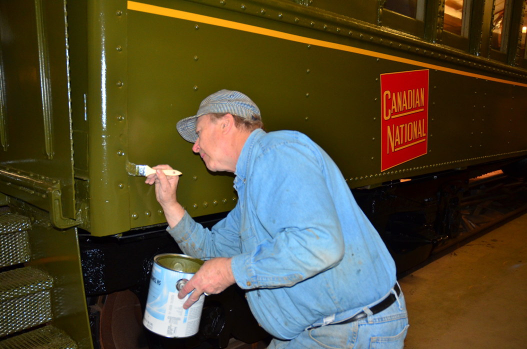

Tony Pratt going around with touch up of the CNR #11 Green.
