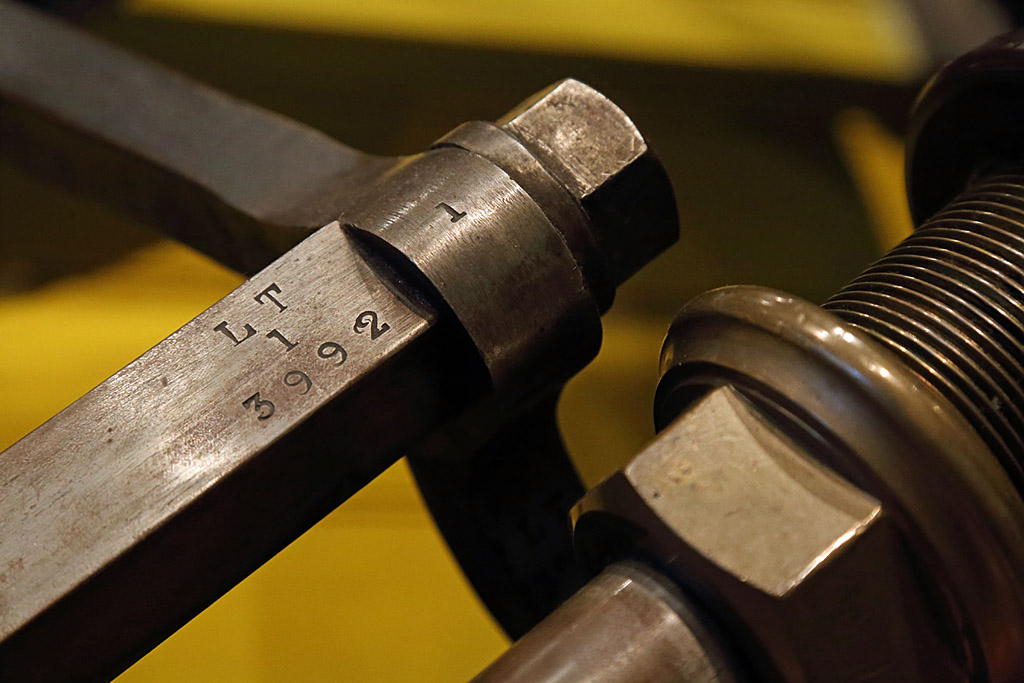

I recently had a chance to visit and photograph Henry Ford's replica of Stephenson's Rocket. It's a beautiful piece (a work of art, really) that was constructed in 1929 using the original methods from 1829. I noticed that most visitors didn't give it a second look (most gravitate to to the Allegheny - C&O 1601 - which is certainly understandable given its impressive size and appearance).
http://www.flickr.com/photos/jterry618/ ... 053709057/

Give an example of the methods from 1829.
 Post subject: Re: Rocket Replica at The Henry Ford
PostPosted: Tue Aug 13, 2013 5:50 pm
Posts: 282
1. No steel was used - only wrought iron.
2. The axles were hand-forged - built up from small pieces of wrought iron that were heated and hammered into a solid mass.
3. The tubes in the boiler were hand made from strips of iron, rather than using pre-made tubes.
4. Copper was used for the firebox, formed and shaped by hand. All riveting was done by hand.
5. Copper piping was made from sheet copper, brazed over a charcoal fire. No commercially-made copper piping was allowed to be used.
6. Authentic period paint was used, made using the original formulas.
