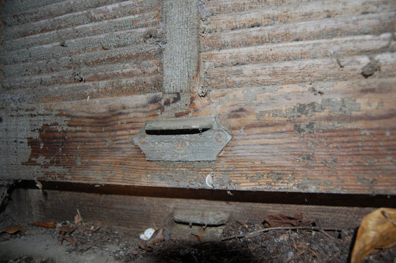

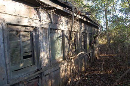

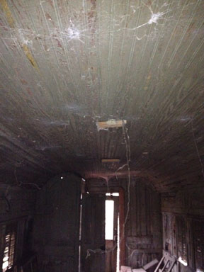

Was wondering if anyone can tell me what type of car this is. I can get exterior photos. It has vertical wide boards with battens on exterior.

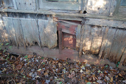

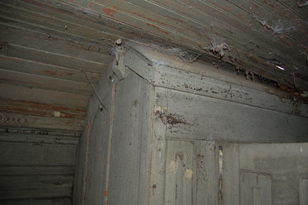

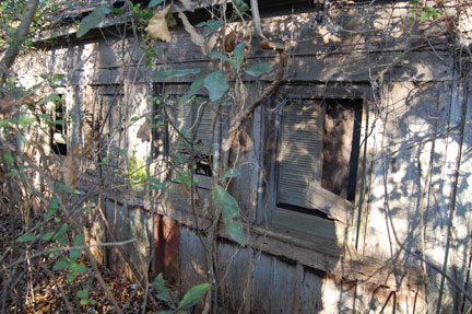

The car is approx 26-28 feet long. Hard to get good exterior photos since the car is in the woods. One corner pretty much gone.

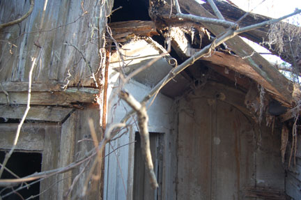

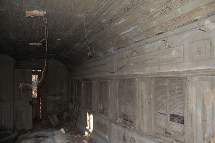

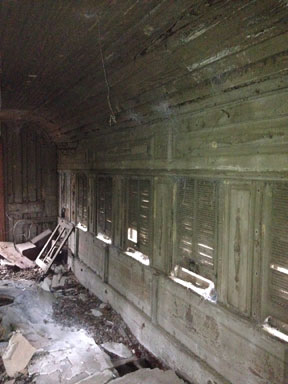

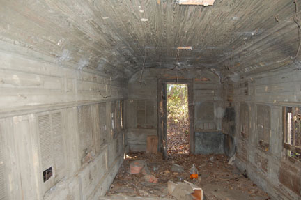

More photos...

Appears to have a clerestory roof above that ceiling, which it should do, can you get any paint off above the doors inside or out to reveal a number ? Looks very old to me much more like 1860's 70's especially with what seems like exterior battens on the sides, I could use those toilet walls and hardware ! Very interesting wish I could see it first hand. You may or may not find numbers on the top of the main windows or the clerestory windows interior or exterior frames. 26ft to 28ft is half the length I would expect though !

Pic 2 shows the arched lower deck roof curving up above the bathroom, then there appears to be the base of the upper deck windows in the clerestory before the shed roof ? The window shades are unusual and the handles on the shades are the a common style listed in the 1890's car builders dictionary, it looks like the outer window frames themselves have handles too and open upwards. Car numbers would be amazing if you can uncover them are there doors on the ends still ?

PostPosted: Fri Nov 29, 2013 2:50 pm
Posts: 620
Location: Albany, Georgia
Looks like a clerestory roof car that has had the clerestory closed off to form the flat interior ceiling. It isn't arched all the way across, but flat between the original curved interior ceiling of the roof's lower deck. There used to be a heavyweight MOW N&W passenger car here in town that was being converted to offices where the same type of ceiling work had been done. Only difference is the clerestory opening was closed off with plywood rather than the bead-board used in this old car.
