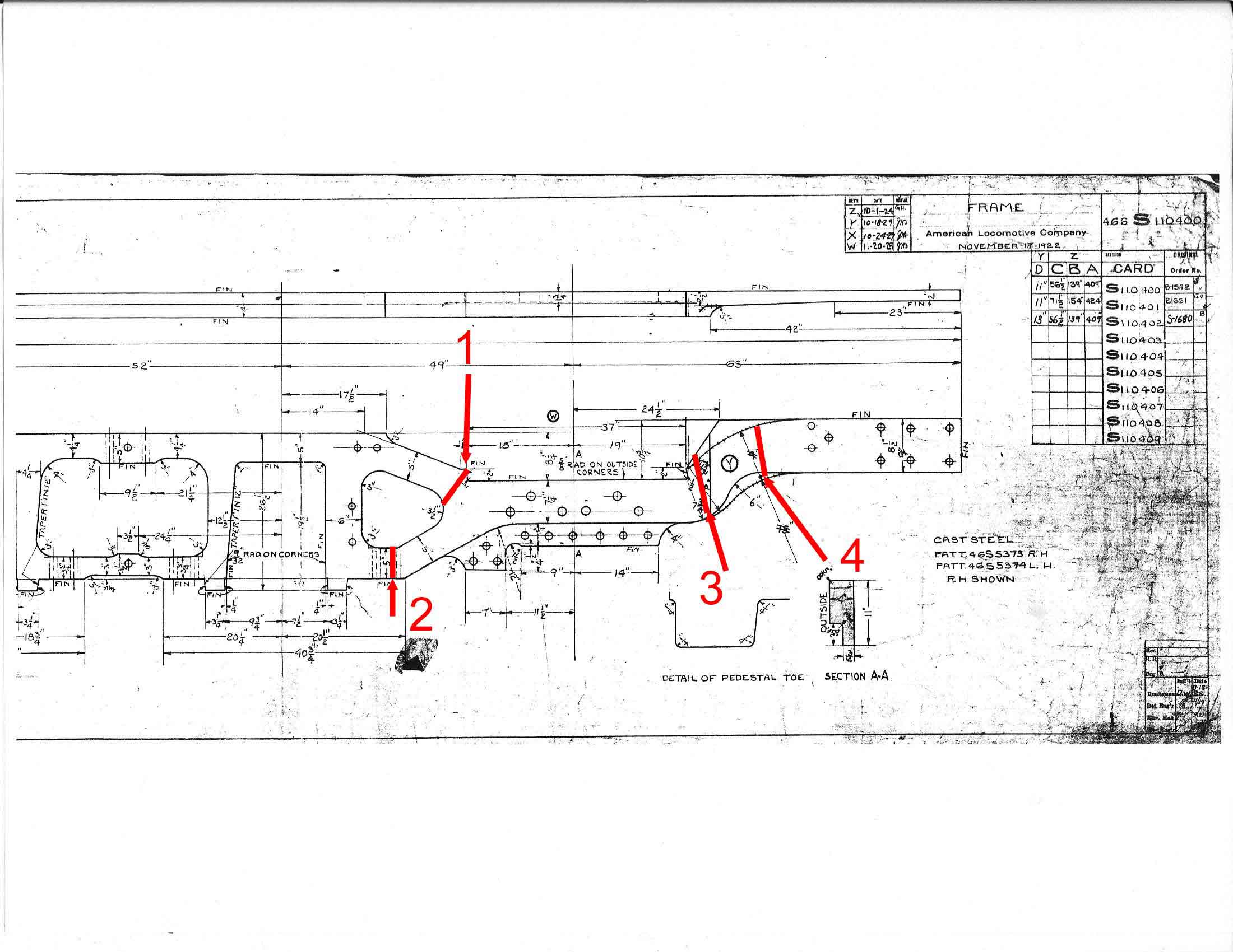

On the assumption that the boiler was the most difficult and expensive thing to repair, for the last several years we have been concentrating on removing tubes, cleaning off scale, and ultra-sounding the boiler for our 2-8-2T logging mike. Now, getting more down and dirty, we discovered several welds in the frame. We are in the process of having them checked by a NDT outfit, to determine how good, or bad, the welds are.
I’ve attached a drawing of the front part of the frame, with red lines showing where the welds are. The two side pieces are mirror images.
Weld #1 is on the fireman’s side frame piece and has a visible crack, so it will need to be ground out and re-done.
Weld #2 is on the engineer’s side frame piece, and is where a bolt hole for the forward binder bolt is drilled.
Weld #3 is on both frame pieces. Note that the space between #1 and #3 is where the cylinder saddle fits.
Weld #4 is on the engineer’s side frame piece.
A couple of possible scenarios as to why these are there: 1) it was in a catastrophic wreck, and the whole front end of the frame broke off; or 2) the cracks developed over time, and probably not all at the same time, due to the bad track conditions it was likely operated on.
So, how serious is this in regard to restoration to operation? Is the frame going to crack elsewhere? Is there any way to tell for sure if the welds are strong enough to hold the frame together? I’m guessing that our track is in lots better shape than what the lumber company ran it on, so the stresses on the frame might not be as much.
I’ve talked to a few people about this, and, of course, their opinions have ranged from, “I’ve seen lots worse that are running fine,” to “Don’t waste your time and money on this, it will never work out.”
Anyone care to add their opinion?
Thanks.

Are you sure about the location of cracks 1&3? I would expect them to start
from the 1/2 in. radius nearby.
As for the quality, the welds could have been made without preheating the frame so the next crack was built in.
I myself would prefer thermite welding for a cast frame, the way rails are "cast"
together using the mixture of aluminum powder and iron ore.

Crack &3 only makes sense as drawn if there were a significant frame void or other defect in the steel. I concur that it "should" have gone through the stress-raising radius.

I'm going to be more practical, and suggest you do some testing of the general quality of the metal in the frame before committing to the project. It is possible that the frame itself is disposed to fracturing, in which case, you might want to reconsider repairing it for operation at all. If not, you may find some history showing a head on collision or something similar which could have been responsible for this kind of damage. It may also be worthwhile to do testing to determine if there are further voids or inclusions in the frames at which new cracks will be more than happy to appear and surprise you at inconvenient moments.
There are also some less exotic but also workable ways to repair a frame that is made of good, weldable metal that you can explore with the more advanced steel fabricating companies in your area. Controlling the flow of heat over time, percussion of hot metal, and other possible parts of the repair strategy will probably be more dependent on what those contractors in your area can provide than an academic ideal technique anyhow.
So, find out if the frames are going to be able to be made reliable before worrying about how to weld them. If your metal is good, then find contractors who do complex repair jobs in stressed frames and choose the best fit for your circumstances.
