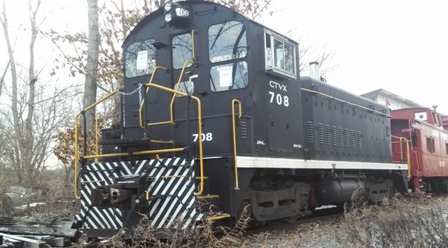

Would anyone have a good electrical schematic for a Production Motor - EMD SW-9; 16 PIN MU, Electro-Hydraulic Governor, Road/Switch Circuit and Drum Controller?
I just purchased the pictured SW-9 and have no good schematic for her original-configuration wiring. Any help to keep this locomotive in service would be greatly appreciated!!!
If you can help out, send me a message.
 Post subject: Re: EMD Transition Related MI's - History List
PostPosted: Sun Feb 23, 2014 1:56 pm
Posts: 2134
I would suggest calling EMD service department:
800-255-5355
Electro-Motive Diesel
9301 West 55th Street
La Grange, IL 60525
