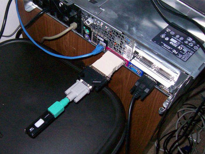

I immediately thought of this when I saw this thread.

 Post subject: Re: Computers of the past, in your future?
PostPosted: Sun Feb 16, 2014 12:37 am
that little usb stick could easily have more storage on it that that old PC there...
Everytime Microsoft does this new OS parts of it are no longer compatible to older things,
and older software refuses to run.
I always hang onto my older systems, and that includes one system with ISA slots.
If you get an old Diesel that actually uses say an old win98 system, you may as well look into replacing the op system with the new to make it functional, with all new everything. if you have some specialists out there who has access to the older technologies, good for you, but manufacturers slowly hand up the towels, but....
you got it, new PC's with ISA slots!
http://www.nixsys.com/products/isacompu ... MgodKEUA-Q
