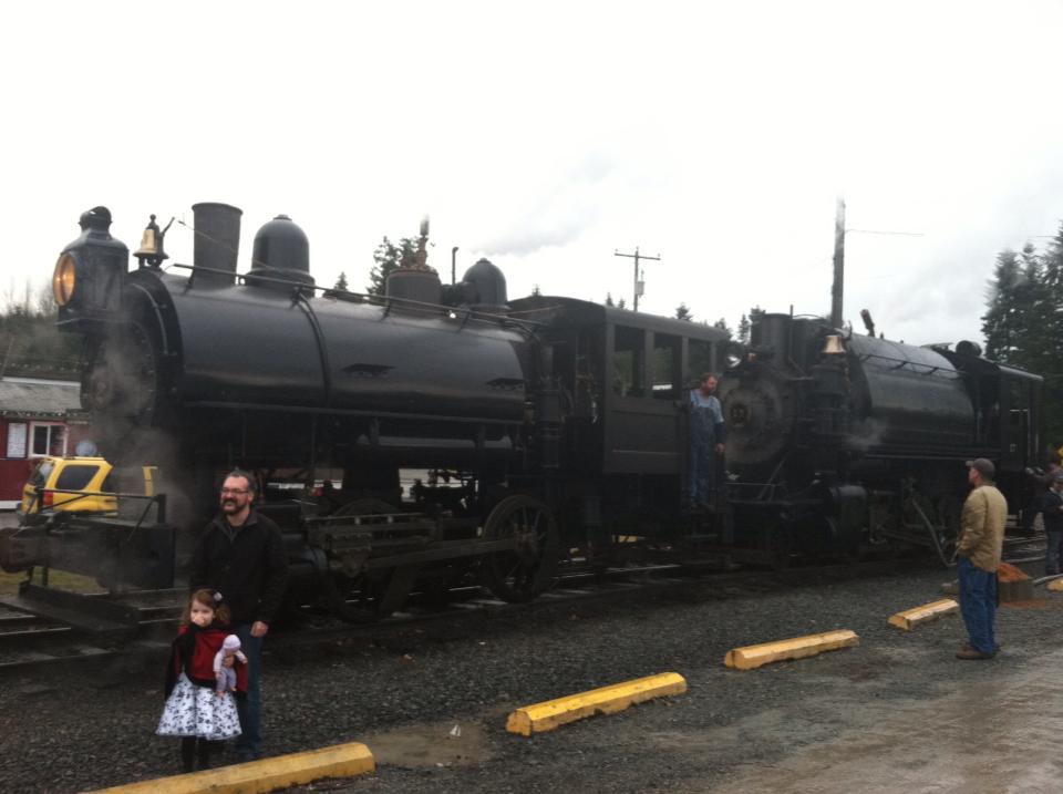

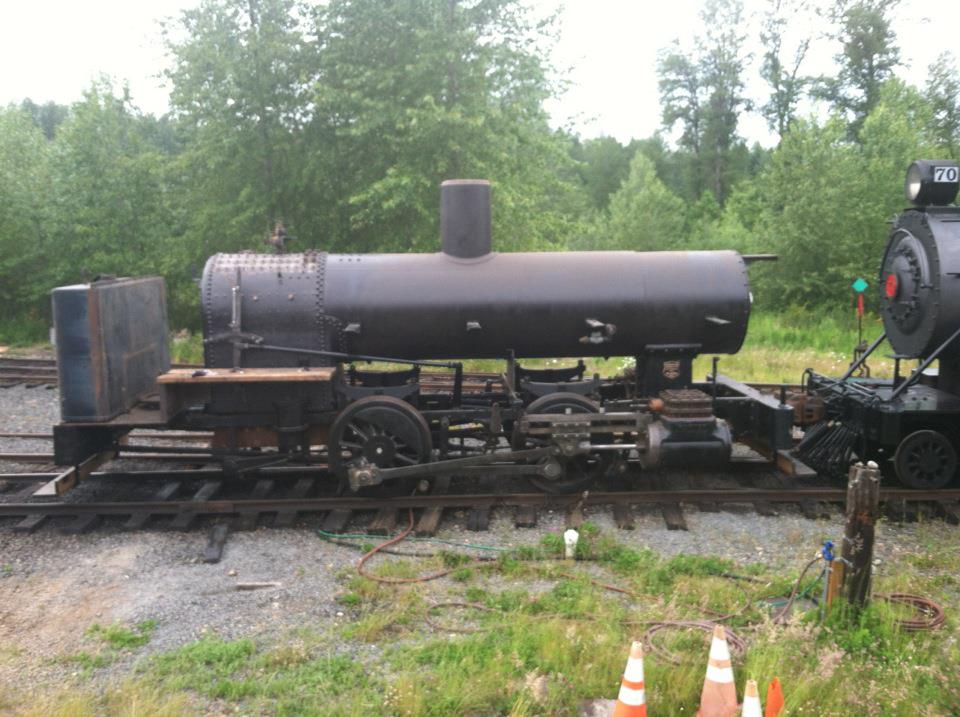

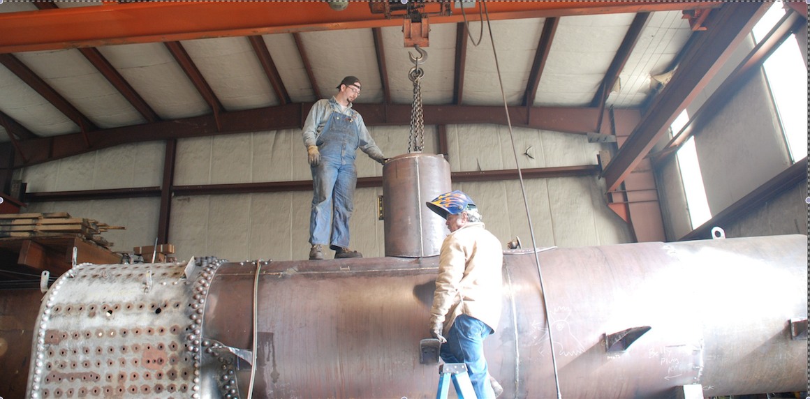

I'm with Kelly on this one! There are lots of talented steam men and women out there, we are actually very fortunate in this country to have so many.
Best,
Stathi
Best,
Stathi
