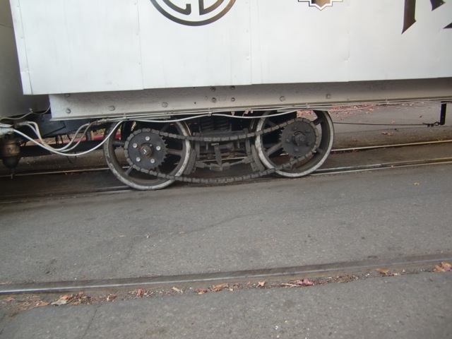

Hi
I was kind of amazed at the amount of slack in the chain on the Goose I rode i this past fall. Seemed to work Ok, but they weren't trying to pull bunch of cars with it.
Cheers--Karl J.
