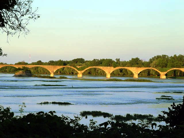

The photo is the streetcar bridge at Glen Echo Park in the Maryland suburbs of Washington, D.C. Several bridges remain in place on this route over 50 years after abandonment.
Wesley

Also, the Ohio Interurban Bridge... http://bridgehunter.com/oh/lucas/interurban/
