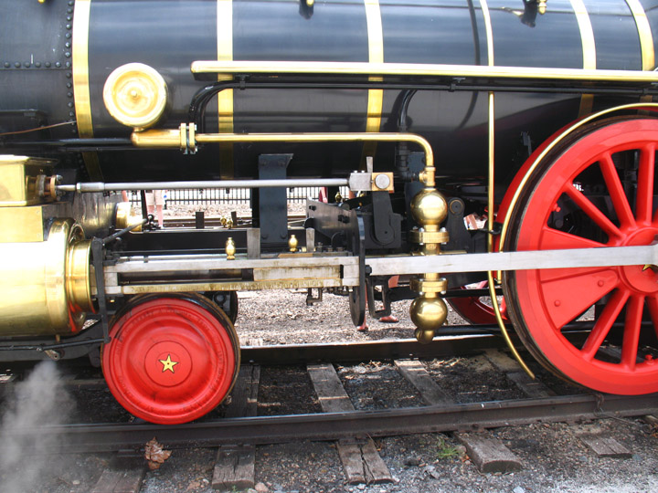

Relevant area of Leviathan. Possibly cosmetic only. If it's a working unit, I believe it is not in use. Others will know more.

The pumps on Klokes engine, Leviathan, and the pumps on the York are dummys. I don't know about Promontory.

With respect to the Leviathan image, it looks like there is a piece of pipe, painted black, under the running board, that sweeps down and goes into a polished brass tee. The tee is between the pump and the boiler check valve. Could this be the delivery pipe from an injector in the cab?

While waiting in line to see the cab of Leviathan at the Michigan Railfest, I asked one of the crew if that was a crosshead pump, and he confirmed it. When I asked if it worked, the answer was 'not really'. So they may be complete, but not usable/practical.
