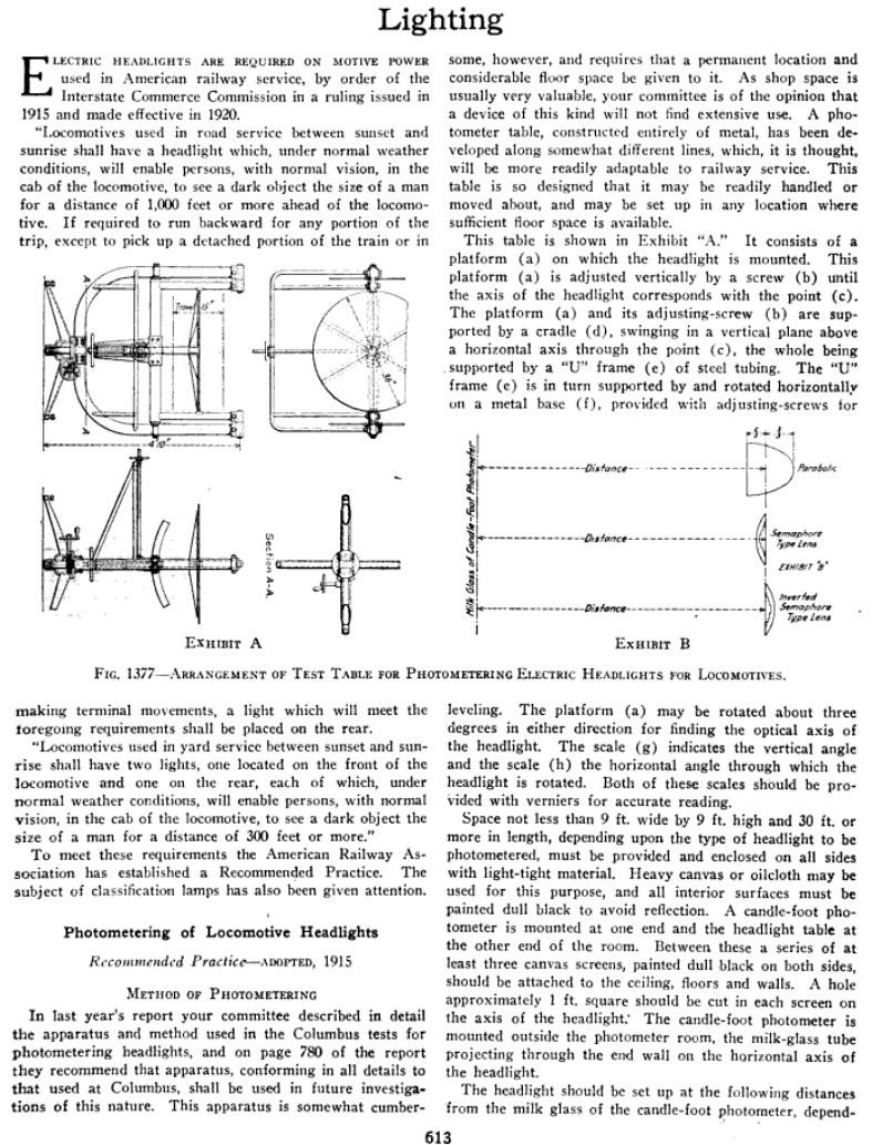

From the 1922 Locomotive Cyclopedia, page 613.

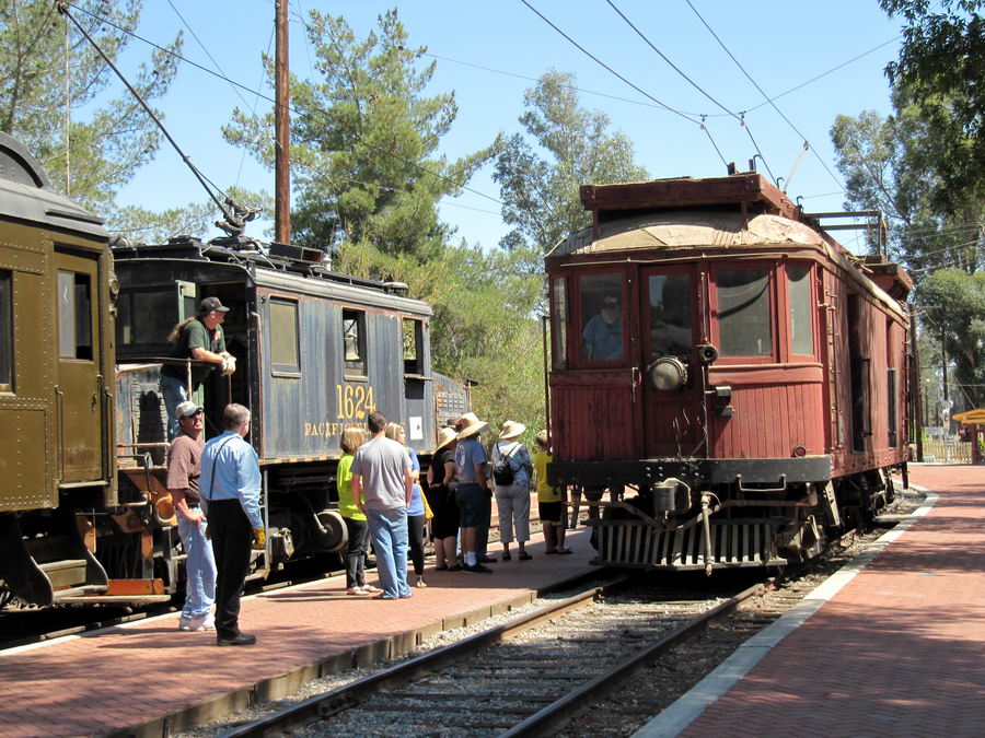

Pacific Electric was still using carbon-arc headlights on some of their interurban cars into the late 1940s.
Here's PE tower car 00157 (PE Los Angeles Shops, 1915) with an arc headlight at Orange Empire. On the other hand, the "Blimps" use "Golden Glow" incandescent lights.

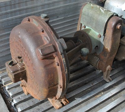

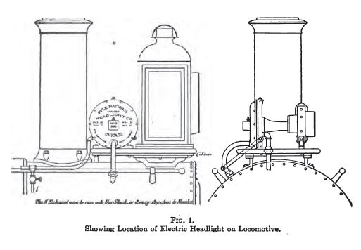

A couple of things on early generators that I've collected and have on my computer.
Part of the text from an ad on Ebay about two years ago and the photo from the ad. Also a drawing from a circa-1904 publication.
Old Original Vintage Factory 1895 Pyle National Steam Train Locomotive Engine Headlight Lighting Cast Iron & Brass Generator Dynamo. The turbine end has "PYLE-NATIONAL ELECTRIC HEADLIGHT CO PATD 1895 JULY 30 NOV. 5 NOV. 26 DEC 31 CHICAGO US PYLE COMPOUND STEAM TURBINE" cast on it in raised letters. It has a small brass tag marked "PATENTED MAR.17 MAR.24 OCT.27 96 JUN..27 AUG 29 1899 APR. 28 1903 SEP. 6 1904" near the top center flange. This is an old as found steam train turbine headlight generator. It is in as found condition. Saved from the scrappers. It has a lot of brass on it. It is stuck and will need restored. Very early rare item.
1895-pyle-national type C-steam-train-locomotive-engine-headlight-generator-dynamo_350523681494.jpg
1895-pyle-national type C-steam-train-locomotive-engine-headlight-generator-dynamo_350523681494.jpg [ 41.34 KiB | Viewed 7654 times ]
