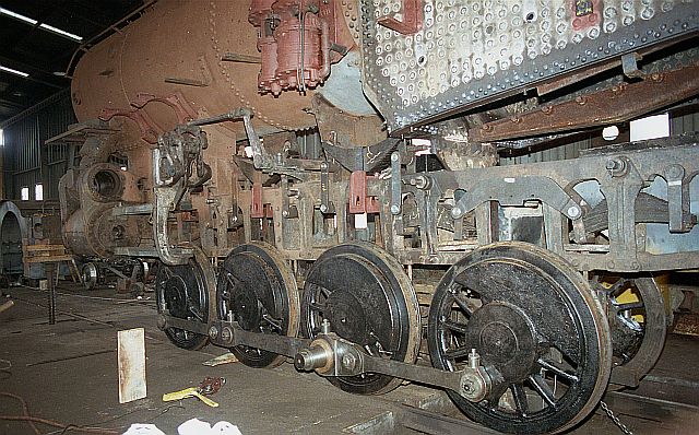

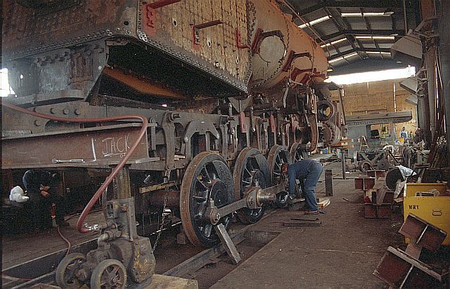

Posts: 329
Western Maryland Scenic RR uses a system of jacks. The former WM Carshop had a pair of Jacks in the floor that were refurbished and those along with portable air jacks have done the heavy lifting when #734 has needed wheel work. The attached photos are from the early 1990's during #734 first rebuild in Ridgeley.

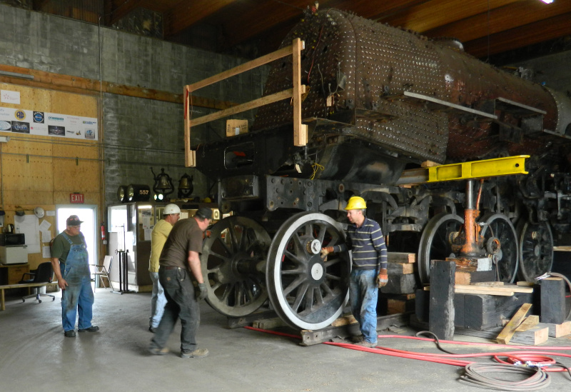

Location: Anchorage, Alaska
We used jacks to remove the drivers and front truck from Alaska Railroad #557 last spring. In the photo, number 4 drivers have just been chocked at the end of the rail and are waiting for movement by the fork lift.
For us, the advantages of jacks were that we had them. We didn't have access to either a crane or drop pit but do have donated jacks and work space.
