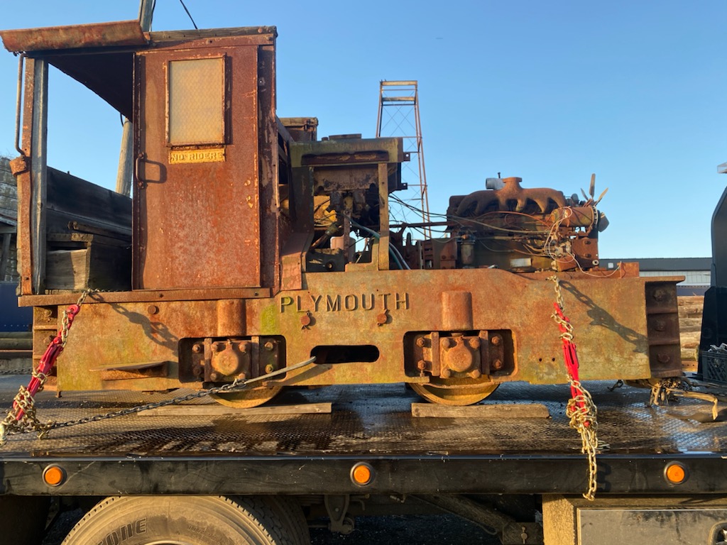

What are the chances anyone out there would have the Plymouth locomotive list and could look up any 3' gauge Plymouths for Hutton Brick Works in Kingston, New York?
By the sounds of it, the list is no longer available. I'd be interested in buying a copy.
Appreciate any help!
J.R. May

John:
This is great, many thanks. At first glance, it would appear that we have the 5065, but then the Connecticut Antique Machinery Assoc is shown as having the 5065. Photos and such would seem to confirm that they indeed have the 5065.
We did find a Hutton pattern in our Plymouth and it came from the same area. Would Hutton have bought it used? Does your list have any other Hutton Plymouths in it?
Based on the side windows and such, would appear ours was a gas engine originally.
Appreciate any help,
J.R.

Many thanks for the help. A key question would be whether Hutton bought used engines from other brick yards in Kingston. The reason I ask is covered below.
The 5065 being in Kent, Ct complicated things a bit for us. We thought we were on to something, but alas the records do not confirm our Plymouth as being at Hutton and do not confirm a number. Via some record searching with an eye on Kingston, Model DL, and the diesel upgrade, Plymouth #2173 has some potential. We will see if we can find some numbers on the motor and the frame tomorrow. A motor number may help us figure out when it was installed which would help confirm if the #2173 is the correct Plymouth number. See what happens. We did find the Hutton brick stamp in the muck in the bottom of the cab and it was with the Vulcan for a lot of years in NY state.
Thanks again all,
J.R. May
