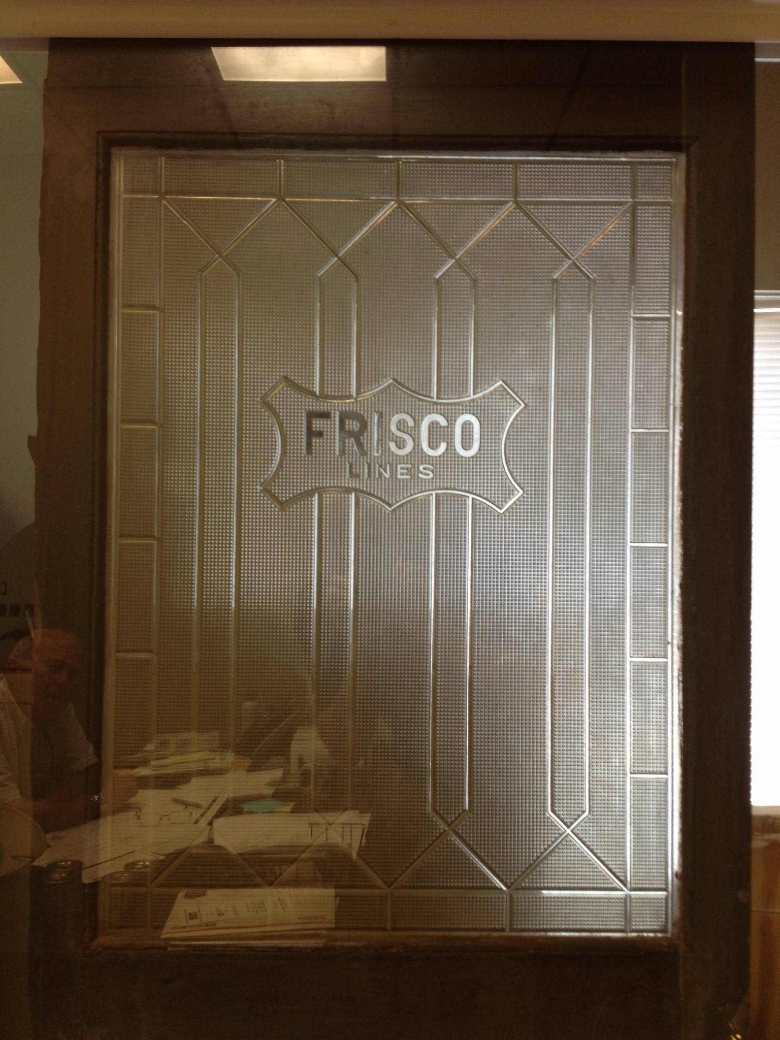

ImageFriscoglass
I suggested etching because one could obtain the general look with easily available technology. One could also make a mold of an existing pane, if one was available, or draw it in 3-D CAD and machine a pattern. The question becomes, what material to cast it from that is clear and will remain so when exposed to the weather.
For that matter, it could likely be machined directly into clear Lexan (polycarbonate) sheet, which is commonly used for impact resistant glazing, so should hold up, but it's not going to be cheap.

Thank you for the responses and leads to everyone who has replied so far. I am attaching a photo of the window we are looking to reproduce. The window would be put into active service on Frisco Coach 1062 located at the Heart of Dixie Railroad Museum in Calera, Alabama. The car is next in line for a much needed cosmetic restoration. The restoration will include replacing all of the windows in the car. We would like to put these windows in the lavatories on each end of the car. We would like to find a way to have the window made out of safety glass since the car will be used and is out in the open.
This may be a lost art in this day in age, but we would like to have the restoration of the car to have as many of the original elements as possible.

Thanks Dennis! Now I know the name of what I'm trying to reproduce! I uploaded a photo of the window we would like to have remade and it is identical to your picture.

So, you DO have an intact window. As was mentioned above, the obvious course of action is to make a mold and replicate it.
A little bit of Googling brought up a web site for Smooth-On crystal clear urethane resin:
http://www.smooth-on.com/index.php?cPath=1120_1156
I've used Smooth-On products before (but not the clear resin) with good results. They claim that the cured resin is UV resistant, and the people who restored the "Red bus" fleet for Glacier Nat'l Park seem to agree:
http://www.smooth-on.com/gallery.php?galleryid=232
I suspect the way to ensure the finished windows hold up in service is to back them up with actual tempered glass; also mount them in the inner sash so real glass in the storm sash protects them from the weather.
