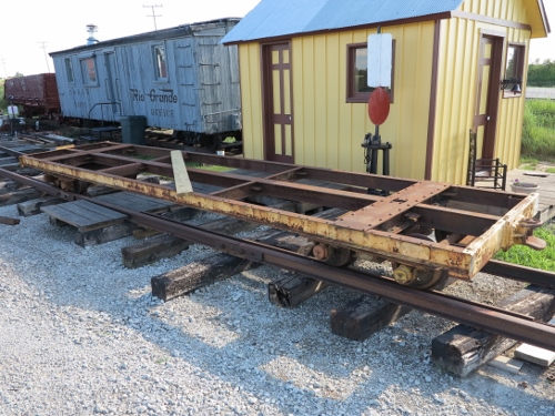

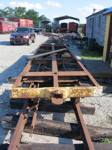

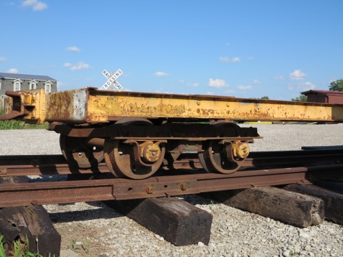

I recently acquired this industrial flatcar in trade and am hoping someone out there might recognize it and be able to fill in its history.
What I know is this;
- Car is 30' gauge, 22' long and 5' wide
- Car was built by the Pressed Steel Car Company of Pittsburgh. (Still has a builder's plate in one corner)
- Car was originally around 16' to 18' long, an extension has been welded into the center. The car has seen extensive use and rebuilding during its life.
- Folks I got the car from got it in Pennsylvania and know nothing else of its past.
Some photos of the car are below;
Thanks
Jason Midyette

Thank you all for the replies. It would seem that industrial flatcars made by the Pressed steel car Co. were fairly common, though the 30" gauge may narrow it down.
The car has seen some serious use and rebuilding, the truck seen in the photos seems to be more or less original as it still shows signs of riveted construction, while the other one seems to have been completely built of welded construction. Both trucks are roller bearing.
At any rate, the car has come a long way since it left the factory.
Termite- thanks for the IRM idea, I will clean the many, many, many and then a few more layers of paint from the builder's plate and see if I can find a serial number. I am amazed that the plate is still on the car considering the amount of modifcations and rebuilding the car has seen.
