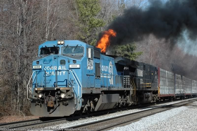

NOT Photoshopped, as far as I can tell:

Sandy, those fires are not of the same type as the fire at the museum, your pics show unburnt fuel reaching oxygen with a source of ignition in the exhaust. While the fire at the museum is typically caused by an accumulation of unburnt lube oil and fuel being retained in the spark arrestors and finally getting hot enough to sustain a continuous burn. It has a unique sound akin to a jet engine. Many times it is accompanied by a burning tar like substance being ejected from the stack. Hopefully all of the maintenance people operating diesels with spark arrestors applied do proper maintenance.

Notice that every one of those flaming locomotives in the photos Sandy put up is a GE. They seem to have a propensity for doing this (dynamic brake grid fires are also not unheard of on GE's). There is even a topic section on one fan site for photos of Amtrak P40/42 "Crispy Critters", that have suffered catastrophic engine fires. It may well be a (lack of) maintenance issue. I'm not sure. I personally never had a GE flame-out on me, but I was with another engineer when I was still a conductor one evening with a consist that included an older Dash-7, that if you goosed it the right way would spit out flames like one of those monster truck car eaters.

To compare what happened in Georgia with the above photos proves only one thing: the posters contentious nature and a tongue-in-cheek attempt at controversy.

All of the pictures above are GE locos, I'd say they all had failing turbos....
I ran a B39-8 a few years back that did the same thing.....you'd get to notch three alright, but go to notch four and she'd bog down, start smoking and after a minute or two would flare up like that and then finally wind up to speed.....usually.
The longer the mechanical guys wouldn't/ couldn't fix it, it got worse, until finally the unit suffers a catastrophic fire or just won't run anymore.....usually they'll still run, they just don't pull very well.....
EMD's on the other hand, tend to start puking oil when they idle a lot....this is often seen as oil deposits running down the hood sides.....at some point, you get the gooey, carbon sludge in the exhausts....which then gets spewed out as burning cinders....
