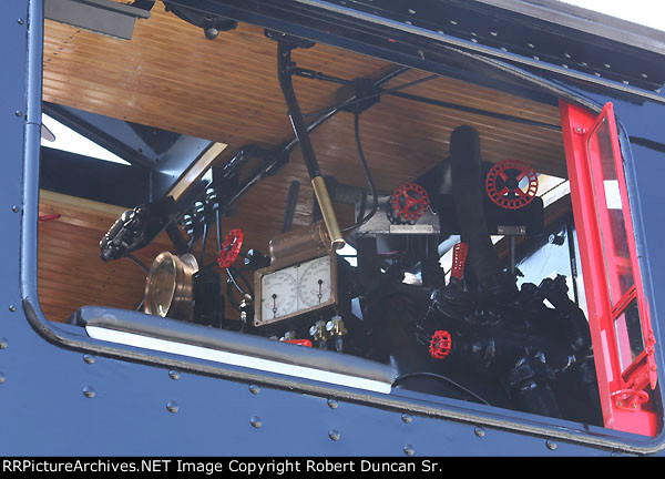

I have noticed that different locomotives have different whistle set ups. Some have chords directly to the whistle itself, others have a handle (like nkp 765), and others like 4501 and 630 have just a rod that stick down from the cab roof (like in the picture). What is the difference between them?

It seems to me that it's just different means to the same end, and the style was up to the company ordering the locomotive.

The ropes to steam whistle valve lever handles are CORDS; the musical assembly of three, four, five, or more different notes/tones that a multi-chime steam whistle plays, harmoniously or not, is a CHORD.
I echo the previous answer; the major difference is simply preference of the owner/operator, be it the railroad or even an engineer customizing "his" assigned loco. In addition to cords/ropes and rod linkage, a scant few larger locos towards the end had air- or steam-actuated valve controls. Contrary to what some folks may think, a properly-adjusted whistle takes little actual strength/effort to blow/pull; the determining factor is a combination of pressure, spring strength, and valve lever length.

Just a quick note here- wire rope was often used, but some roads, (NKP comes to mind) used non-metallic rope in electrified territories. A metal bell or whistle rope, if broken, could spring up and make contact with the overhead, setting off some fireworks and possibly causing injury to the crew. And you have to be very careful on a steam locomotive using a rake or hoe while under wire, as well.

Personally I prefer a lever or cord operated whistle to some of the later air/steam operated setups for the main reason that it's a lot easier to 'bend' the notes on a lever/cord where as the air operated ones I've encountered are either on/off.
