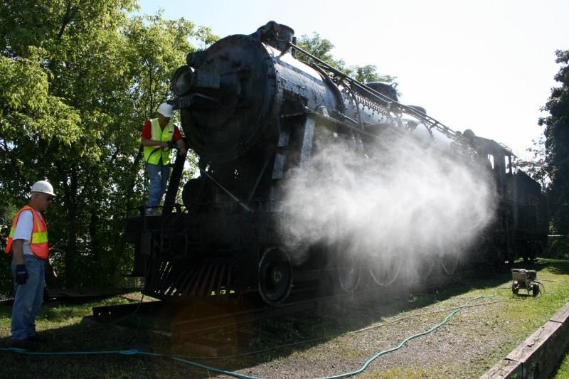

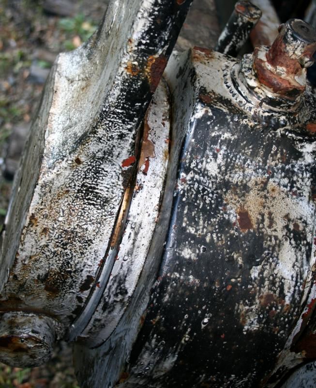

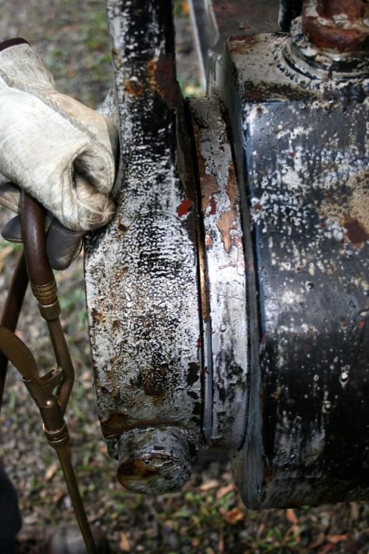

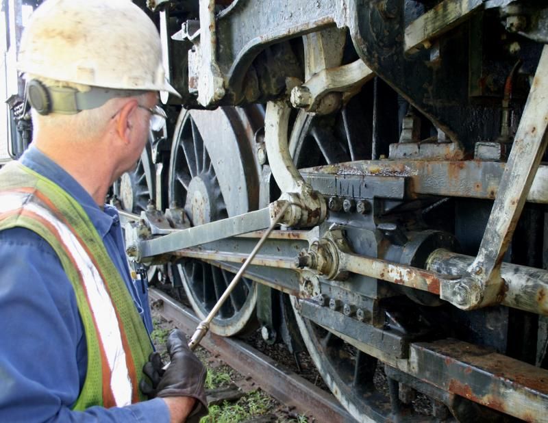

Over the past few weeks, volunteers have met at the locomotive to begin applying rust penetrant and oils, in this case, a mixture of acetone and automatic transmission fluid. Two weeks ago, we began by applying it with brushes to every suraface that should move. Yesterday, the effectiveness was only too clear. the rods have opened, there is some "little" movement, and we could began loosening up the joints. A rental office in Waterville donated use of a power washer and Pan Am allowed us to use their spigot to give 470 its first cleaning in sixty years. A three man team spent four hours washing out debris, broken glass, and probably a thousand pounds of ballast from the frame, ash pan, and every tight space where it could accrue. Some material was bagged for removal.

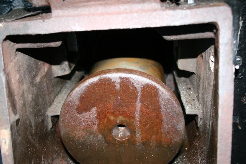

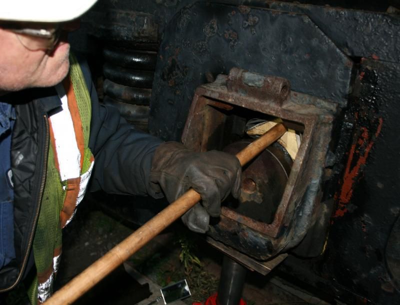

After the washing, a second team arrived and reapplied rust breaker lubricant. They got into crevices which were painted shut and filled with matter only two weeks before. Several journal boxes had been filled with storm water and generous helpings of stone ballast. Drain holes were drilled and the water piddled out. Workers went in with gloved hands and scooped out the stones. The bearings will be inspected, cleaned, and re-lubed. The holes will be tapped and plugged. Eventually donated roller bearings will replace the friction surfaces, but maintained to appear as historically shown.

Removing grit accumulation from tight spaces.
Cleaning the pilot deck.

Rust penetrant is liberally applied to all moving surfaces as a rule.
Journal boxes which have been filled with storm water for years are finally drained. The boxes will be jacked, cleaned, and re-oiled in a few weeks.

We went down to 470 yesterday to do the usual lubricating, but also inspected her bearings. We checked all but two of the tender bearings, and the ones we checked looked spectacular. The local ABC affiliate showed up, check out the video

Those visitors who did toss in ballast, tossed in more than a few pieces. We extracted bottle Pepsi bottles, rocks, pop-tops, and just about anything else you can name. That doesn't account for the tender which will have to be cleaned by people in haz-mat suits.
The journals, however, were a treat, being clean and shiny. We will next be attacking those portion which were submerged with Scotch-Brite, then relubing.

Next time you jack those journals up, you might want to place a piece of plywood or rubber between the jack and the bottom of the journal. Metal-to-metal contact is slippery.
An acquaintance of mine now has a slightly shortened finger when the jack slipped off the journal due to an incident many moon ago whilst "jacking & repacking" a journal.
Good to see substantial progress being made.
 Post subject: Re: Maine Central 470 update.
PostPosted: Thu Sep 25, 2014 11:24 pm
Posts: 110
Actually, your not jacking the journal up. The axle doesn't move. The axle box is what is being jacked.
Bob D.
PostPosted: Fri Sep 26, 2014 10:31 am
Joined: Mon Jun 04, 2007 8:25 am
Posts: 133
Location: Across the river from Baldwin's on the Naugy
@Bob D
You are, of course correct. You do jack the box.
The point being is to avoid metal-to-metal contact when jacking......
Sometimes however, the axle will rise up with the box & has to be restrained by a widget which goes under the jack & hooks over the wheel plate just above the tread to prevent the wheel from moving.

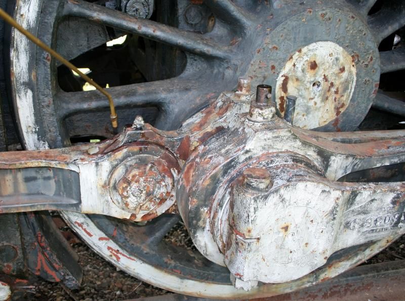

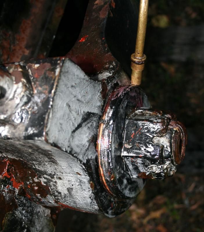

CMO Leverett Fernald, uses a tool to polish the surfaces of several axles, to clean and resurface prior to the onslaught of winter. These have been polished some, bathed in oil, and with receive a protective coating of a thick "Cosmolene" type substance, used in machining.
Before wiping clean, the results are implied in this photo.

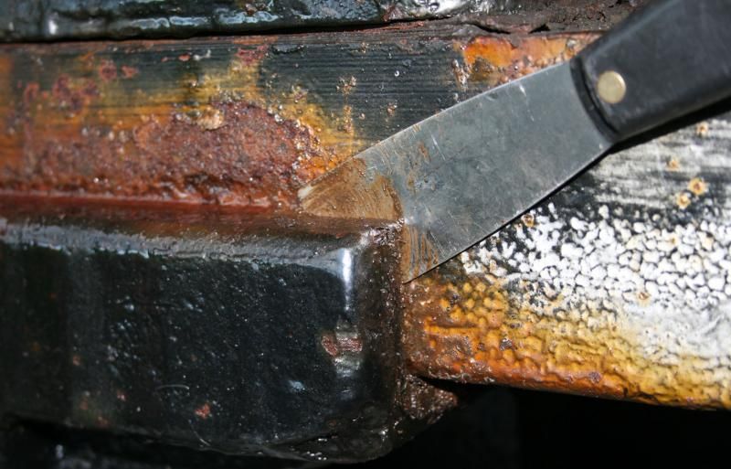

The crosshead guides have been severely weathered in the past 60 years, but after multiple applications of acetone/automatic trans. fluid, and a little time, we are beginning to see progress. The old paint is dissolving and grit and rust are beginning to give way to lubricant.
Saving the best for last, the brass bushings on 470's rods are being revealed and lubricated for the first time since June, 1954. These are enormous, and oil just disappears into the new openings. Each lubricating session presents a little more satisfaction in this respect. The newly freed surfaces will be coated and covered over the winter.
