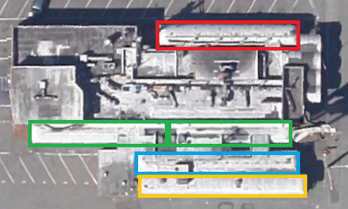

Rainier Rails wrote:
1. In the entry for the restaurant (http://www.bera.org/pnaerc-orginfo.html#Orient%20Express%20Restaurant), the Hicks-Hakner database lists an unidentified MU commuter coach: http://www.rrpicturearchives.net/showPicture.aspx?id=3994370
Well, unfortunately that's not the car that I had thought was the MU car in Andy's Diner/Orient Express. At one point I had been sent a photo (supposedly) taken inside the building showing what looked to be the end of an MP-54, so that was why I theorized that there was an electric MU car somewhere in the structure. Not having been there, it appears I was mistaken; the car in the photo looks more like an early steel coach and is almost surely not an MU car.
I've attached an aerial view of Andy's Diner (hopefully this works!) with the five railroad cars I know about highlighted. The Pullman obs car is in yellow, the unknown steel coach in blue, the two OE interurban cars in green and the Harriman car in red. Assuming that there aren't any other cars buried in the structure, I'd say it's a safe bet that I was in error about the MU car.

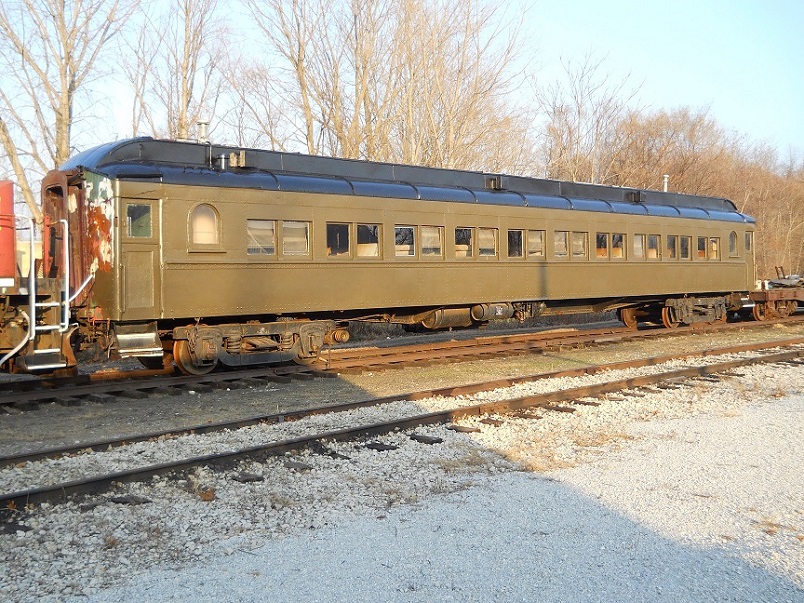

4. This coach is stored at the Mount Rainier Scenic yard in Mineral, WA, stenciled as BA&P #441; the trucks are stamped D&RGW. I have no further info on this car: http://www.rrpicturearchives.net/showPicture.aspx?id=3905885
Don't know for sure, but my guess is that this is a sister car to the one which I am part owner of, and which is located at the Hoosier Valley Railroad Museum in North Judson, Indiana (see photo attached). Note the similarities in window placement. It also has the step extensions. Car was built by Pullman in 1910 for the Western Pacific and later went back to the Denver & Rio Grande. The car has three D&RGW stamped trucks (the other one is stamped D&SL). Somewhere I have a list of where all these cars ended up and if I can ever find it, I'll post it here.
"David.....and throwing stones" thread: http://www.rypn.org/forums/viewtopic.php?f=1&t=35746
First of all, the Lot consisted of a total of 51 84 seat coaches, built between July and October 1910. 40 of the 51 cars were initially leased to the WP as #301-#340, and the other 11 cars were owned by D&RG as #888-#898.
Also, in the "throwing stones" thread, Les Beckman states that most of these cars later had A/C installed, the cars that did not receive A/C were used for extra capacity and were later sold to Algoma Central, including the car that Les now owns, #899/#930.
Algoma Central acquired 15 of these cars as #400-#414:
The numbering histories for several of these 15 cars are known:
WP #334 (with smoking compartment) to D&RG #946 to D&RGW #954 (2nd renumbering) to AC #408 retired in 1980 and sold to Prairie Dog Central #101.
WP #313 to D&RG #918 to D&RGW #951 (2nd renumbering) to AC #409 retired in 1980 and sold to Prairie Dog Central #102 (not used in service).

Ted -
Concerning the 80 seats vs. 84 seats mentioned above. The car has 80 "walkover" seats and there were also two aisle-facing "long" seats (one in each corner of the car opposite the restrooms). Perhaps this is where the other 4 seats came from to get 84 seats.
 Post subject: Re: Mystery Cars
PostPosted: Fri Jan 30, 2015 11:13 pm
Posts: 2112
Les Beckman wrote:
Ted -
Ah-ha.
These corner seats were a common feature in higher-capacity walkover coaches during the all-steel heavyweight era, and it was also common practice for the railroads to later remove either 1 or both of these seats to make room for water coolers, conductor's desks, or the like, so I'm guessing this is exactly what the Rio Grande did. Unfortunately the Rio Grande diagram folios I have and the scans available online do not include a diagram for any one of the unmodified cars which were later sold to Algoma Central, so I don't know exactly what D&RGW replaced these seats with, or when.
Ted Brumberg
