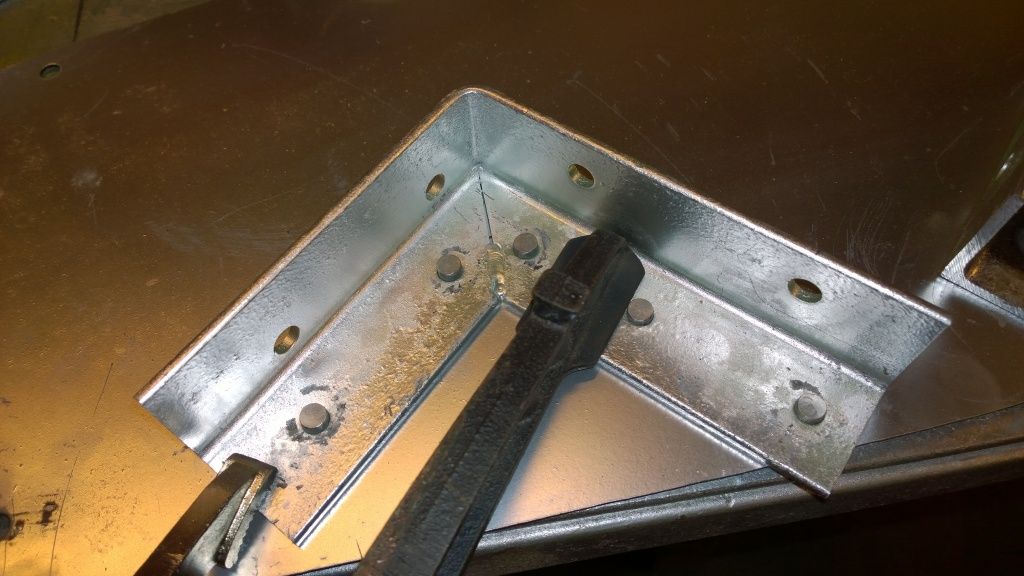

As I was working on the new stairs for Central Vermont Ry 4052 caboose, I started wondering why hasn't anyone mentioned this method as a restoration alternative for riveting. Our original stairs have turned to iron lace so as part of her restoration we are building new ones.
The original risers and treads were mounted to angle irons that was riveted to the side panels. As we don't have a working rivet gun (other then POP Rivets...) but wanted to keep the mechanical strength and look came up with this method that as of yet has not been mentioned here (that I remember). All the others involved welding the assembly and gluing rivet heads to the surface, or bolting the assembly with button head bolts and filling the hex socket with Bondo.

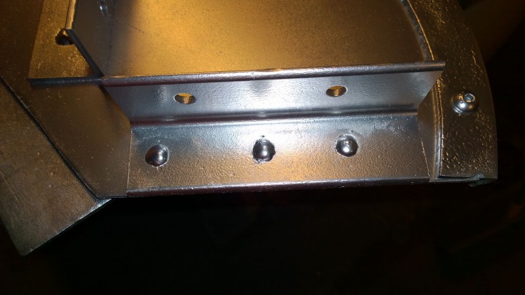

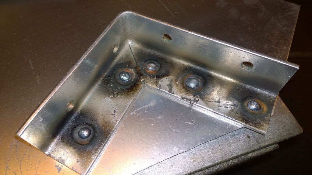

Basically the side panels are prepped the same as if they were going to be riveted, regular rivets are installed and everything is clamped so that everything is as compressed as possible and the tail of the rivet is melted/welded over with a TIG welder, leaving a round rivet like head on the hidden side of the assembly.
As you can see the tail is welded to the hidden side, and as it cools the rivet draws the pieces even tighter. If both sides were going to be visible, one could go back and shape the weld with a rivet gun or rivet hammer.

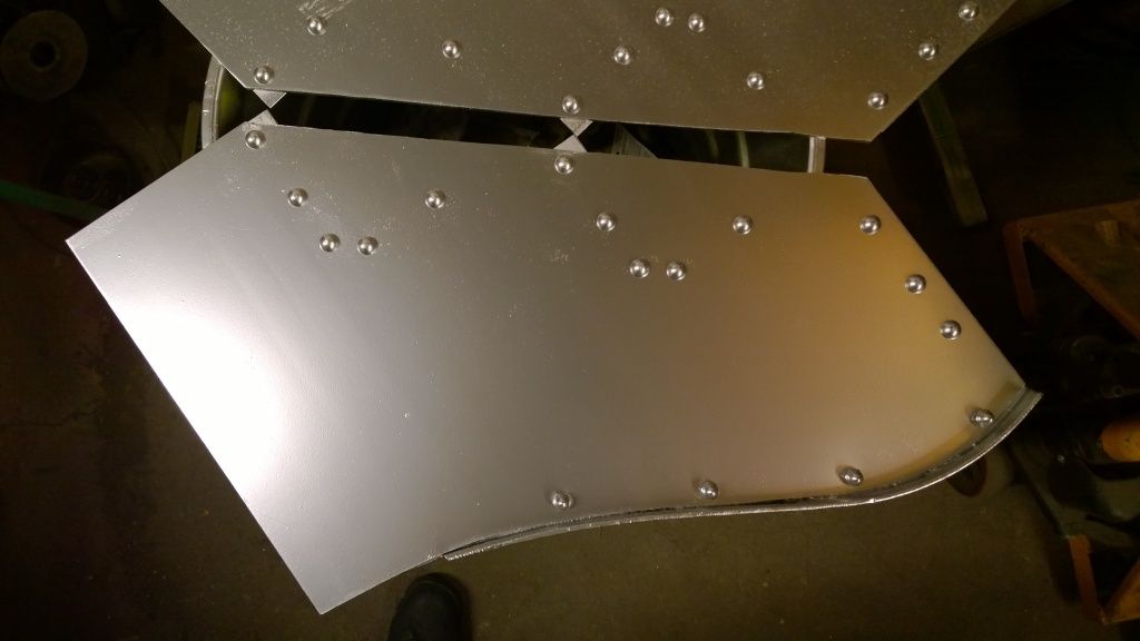

here is what the outside face looks like:

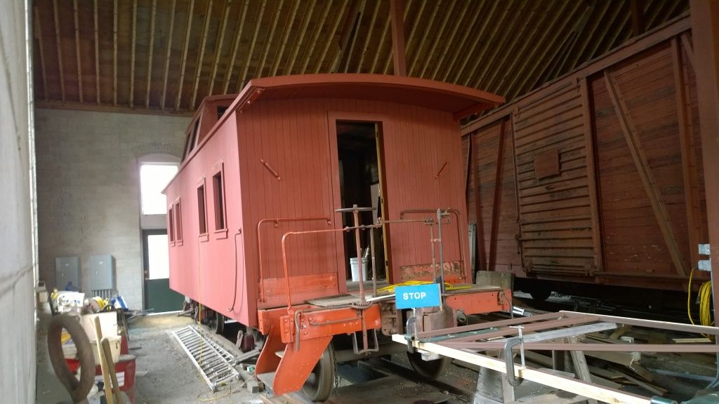

and here is what the caboose is looking like, currently only in primer, final coat will be the red/orange that CV used on their cabeese (last I heard)
If you look close you can see a faint line just above the 3 horizontal rivets, from the weld.

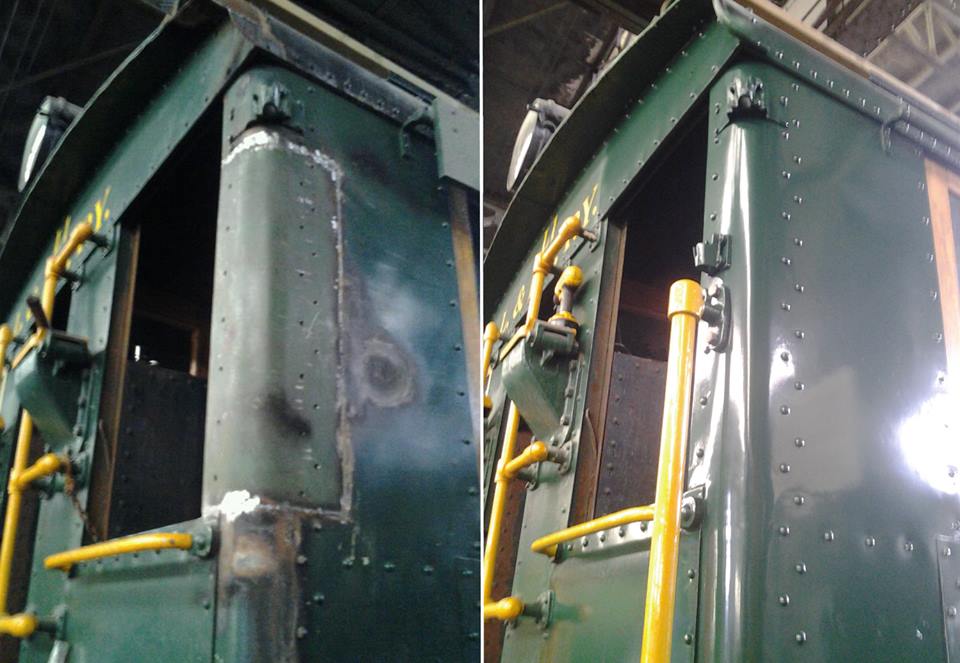

This is a repair I made last winter on our London & Port Stanley Railway, GE boxcab electric #L1. The rivets were installed by welding them on the back.
Elgin County Railway Museum - http://www.ecrm5700.org
