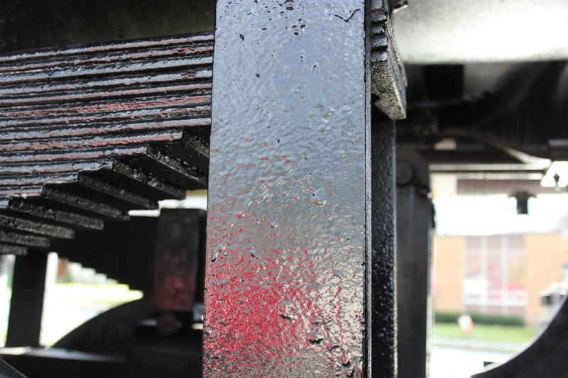

Recently in this thread viewtopic.php?f=1&t=37114, it was suggested that the Union 0-10-2 in Greenville, PA may actually be the 303/603 instead of the 304/604.
"Thanks for your comments. The report that the engine returned by the Missabe to the Greenville roundhouse for preservation was 603/303 is in the book published by Frank A. King "Locomotives of the Duluth Missabe & Iron Range". Mr. King worked for the DM&IR and also photographed their locomotives. Did he get it wrong? Possibly, although he was pretty meticulous of his facts. Take a look at the very first photograph in the referenced rrpicturearchives sequence of photos; the one that is in black and white and was taken in May of 1960 when the 604 was still up on the Iron Range. Note that running board has a little "jog" in it right about where the firebox starts. The engine now on display there in Greenville, doesn't have that jog. Why would they have removed it? Of course, I don't have an old photo of 603 (URR 303) to see if its running board was straight in that area. Anyone got a photo of that locomotive? Also, you say that you verified that the BLW c/n belonged to the 304 and not the 303, but the builders plates are missing on the engine displayed there in Greenville. They were on the locomotive when in service on the DM&IR, but removed. Who removed them? They don't appear to be on the locomotive when it was still in the B&LE roundhouse in Greenville before being put on display. Could the builders plates you saw been from another 0-10-2? Maybe the 604/304? And that corresponding number then painted on the engine? I'm not yet convinced as to what engine is actually on display. But I am willing to listen to some facts. To those who think I'm just nitpicking, I apologize for taking up the space.
Les"

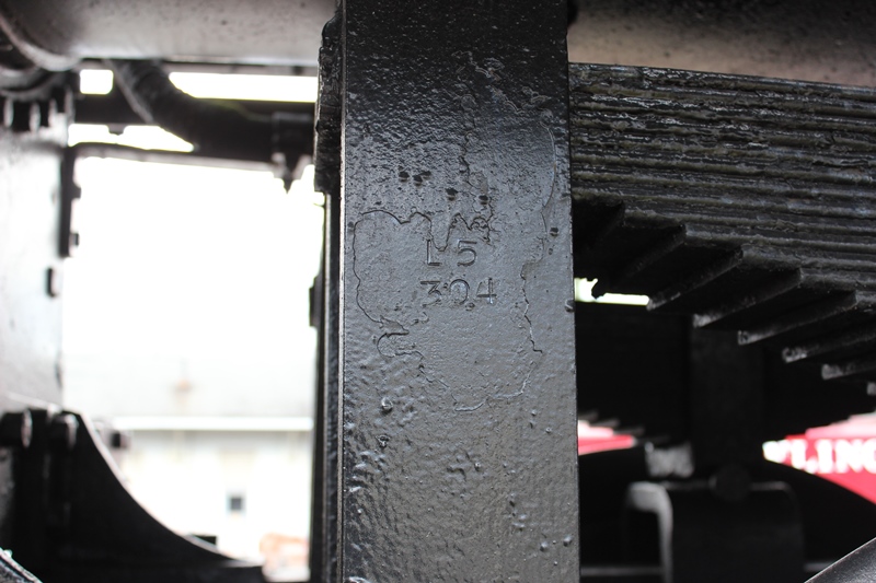

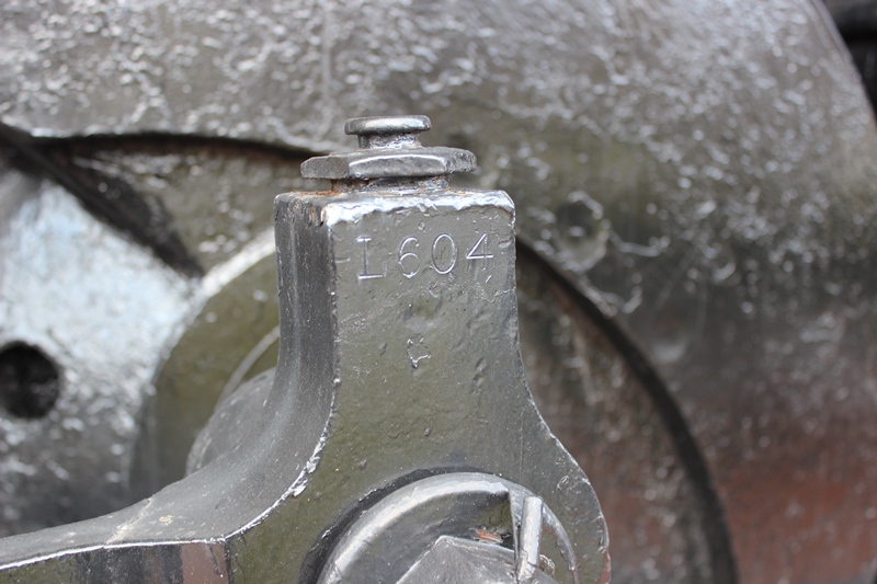

This was of particular interest to me because this locomotive is one of my favorites, having spent much of my youth climbing around it and I still live only about 25 miles away. So today a friend and I took a drive over to Greenville to attempt to dispel the rumor that the 604 is not who she appears to be.
Fortunately for preservation's sake, but unfortunate for identification purposes, the locomotive has recently been completely repainted with a good thick coating. This does obscure the ID marks stamped in the parts but I did find enough to give a definitive answer to this question. Aside from the parts photographed, I found several more with either 304 or 604 stamped on them.
As to the bump on the running board, at the location where that bump was located, there is a new section of running board that extends back to the cab. A weld can be seen in that location. Whatever appliance was in that area was removed at some point with the running board being replaced.
I hope this settles the matter.

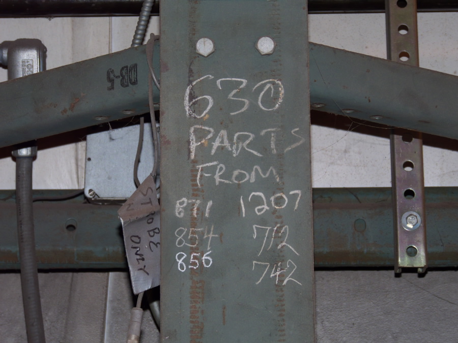

I won't challenge the evidence that the Union 0-10-2 is indeed the 604, but a noted by others, some railroads did swap parts around. While rebuilding the Southern 630, someone at TVRM with a handy piece of chalk kept track of such discoveries.
Alan Maples
