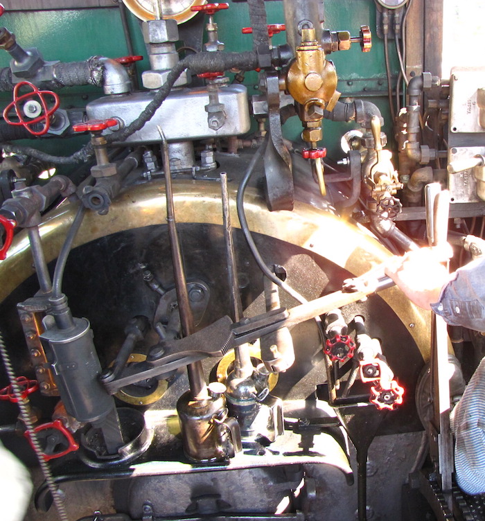

I'm looking for an appropriate and useable oil can for a 1904 Porter locomotive.
I suspect the bronze ring, which measures 4-1/4 inches inside diameter and 1 inch deep, is for an oil can. The oil can in the photo doesn't fit properly because the handle is too low and the body interferes with the throttle.
I've been watching eBay but I honestly don't know what style to look for.
Any help would be greatly appreciated.

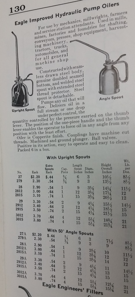

For some reason I've become acutely interested in Porter locomotives as of late, and would like to know a bit more about this locomotive. What is it? Where is it? Operable or static?
Here is a photo of the Eagle oilers that an industrial supply house listed including dimensions. You need something that is 4" dia. or less and with a handle that begins at least an inch up from the bottom of the can. I have a few Eagle railroad oilers at the museum and I'll measure them when I get over there this afternoon.

his problem was the taller can hits the throttle, he needs a shorter can
 Post subject: Re: Locomotive Oil Can
PostPosted: Mon Jan 19, 2015 4:50 pm
He wasn't clear if it was the spout that hits or the an itself. Looks to me that the can is cocked sideways because the body is hitting the throttle rod.
A shorter valve oil can for the hydrostatic lubricator makes sense to me.

Below are some dimension for the oil can which I originally posted.
The spout is about 14-1/2 inches long which would help to reach the eccentrics.
I haven't found any manufacturer's markings on it yet but it was copper color and somewhat similar to another I have, made by Eagle.
1900 Porter catalog says locomotives are furnished with tools including two screw-jacks, tallow and oil cans, monkey-wrench, flat wrenches to fit all bolts and nuts, steel and copper hammers, chisels, pinch-bar, poker, scraper and torch. These items all disappeared and I don't know exactly what they looked like.
A reprinted Davenport Repair Parts booklet, similar era, shows an "Engineers Oil Can" that is similar to the one I have shown.
The body is interfering with the throttle so I could separate the oil can at the soldered seam and shorten it. I could also possibly reform the handle to raise it up at the bottom. The spout seems to have sufficient clearance.
