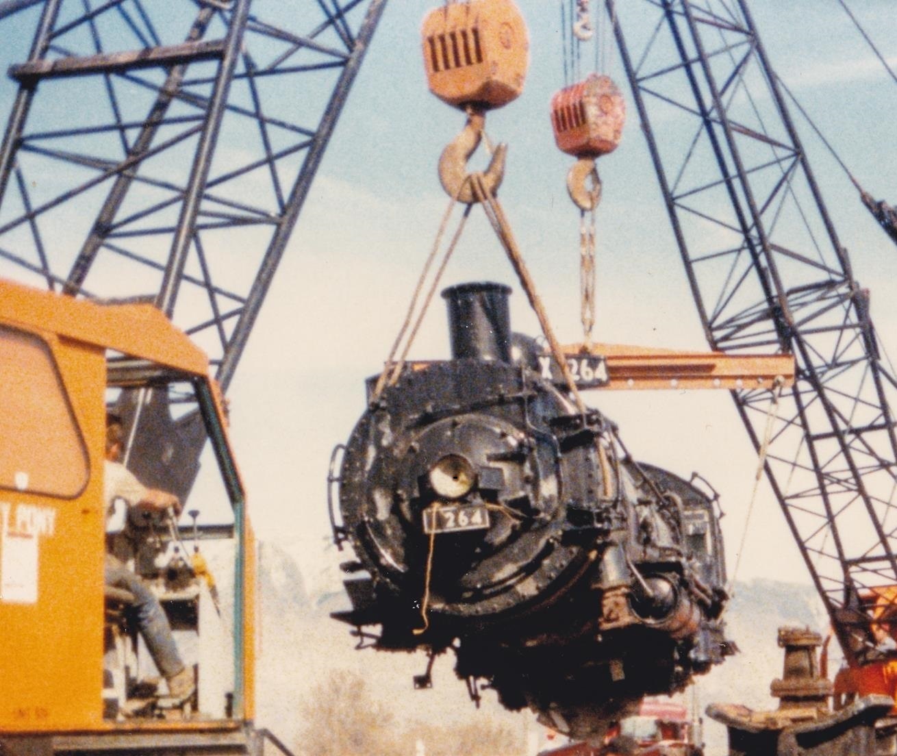

[quote="Randy Hees"]We have 264 (aka 6264 at end of steam) at the Nevada State Railroad Museum at Boulder City... under cover, cosmetically restored as a static display piece. We have no plans for an operational restoration. Locomotives of this class opened the Boulder City branch, so approprate and she is well loved if not used...
There are a couple of reasons...
1) In the case of 264, she has suffered while in preservation... The boiler was separated from the frame at some point, and is only sitting in place at present... the pistons and piston rods are missing, Some valve gear is missing, and she has had many of the hard to locate parts like injectors taken to support other preserved locomotives (before she arrived)... It would not be a cheap restoration. Descriptions of the repairs to other locomotives in the class are not unknown but we have not confirmed such issues... we would not start disassembly until we had a basic plan (including funding) to rehabilitate and reassemble... this is Nevada State Museum policy. We don't like locomotives in pieces on pallets in suspended restoration on site...
Here we see a picture of the boiler off the Frame of 264 at Corrine in preparation to move to Heber! In April of 1980. This photo came off my FaceBook page "History of the train in Heber City Utah" Forum Member Parker Wilson posted it. (I had to heavily crop it to post it if you want to see the full image here is a link to my page.https://www.facebook.com/photo.php?fbid ... =3&theater)
 Post subject: Re: UP C-57 Class
PostPosted: Mon May 09, 2016 11:17 pm
Site Admin
Posts: 1505
Location: Henderson Nevada
Thanks for the image... it has been added to the locomotive's history file...
While we are not planning a operable restoration it is nice to know that there are so many similar engines out there... we can find parts to copy when (and if) the time ever comes.
Randy
