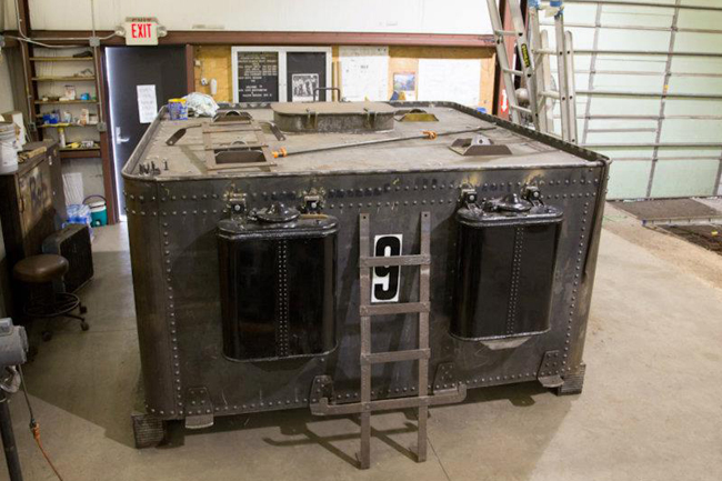

The recently completed water tender sits on the shop floor waiting to be lifted onto the top of the tender frame.

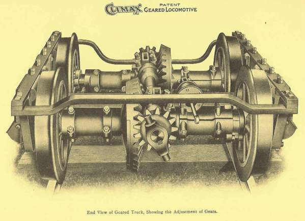

Instead of speculating, let's look at some source material. At least from this one drawing, the nuts were on top.
Like the catalog I linked to?
Right, that's the second of two catalog illustrations that I linked to previously. (Click on "next page" at the link and you'll see the same image, excepting the logo.) So you're simply speculating based on a picture in the catalog, just like I was.
That illustration tells you what Climax was doing at the time they printed the catalog. It may, or may not, indicate what was done with the engine under restoration. I presume they used the same technique, but I really have no way of documenting it. The folks at cass may or may not have additional data.

Bob,
The one difference I note in the illustration and the photograph is that the illustration shows double nuts used to secure the truck bolts. This would seem to lessen any proposed dangers of loosing the bolt.
However, after just perusing photos of Climax locomotives, I see the bolts both "up" and "down." It is interesting to see this variation, and I wonder if the "down" position reflects in-service rebuilds or preferences of the owners of the locomotives.
It would be interesting to hear from Cass about this, but I imagine they know what they are doing, and have a reason for doing what they are doing with regard to this truck.
