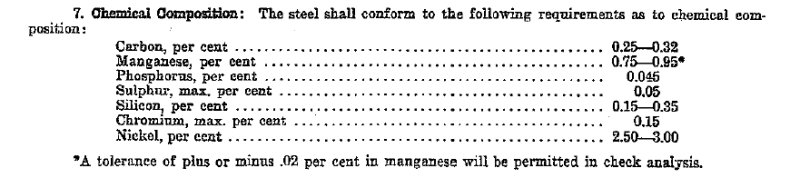

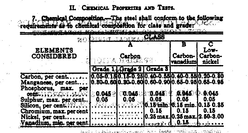

T&P rods almost meet the AAR M-105 Class C except Carbon is 2 points too high...
and does meet UP Common Standard-82 same as UP "Jableman" power...
