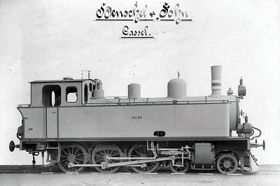

Helsingør - Hornbæk Banen No. 4 is a re-activated restoration project that was begun over ten years ago. Our group had the typical kind of crash in core volunteers and new recruitment. In the meantime, the last wheel shop in Denmark (?) has been demolished. This engine is supposedly the last engine to receive wheel work in Denmark. Unfortunately, it was a rush job, and incomplete. A couple of pins are off axis.
Germany is now the go-to place for engine work in Europe, and as you can see in other posts, sometimes this works, and sometimes it doesn't. Plus, shipping some wheels off to Germany is not exactly cheap (dis assembly, transport, paying someone else to do the work).

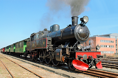

HHB no. 4 has original pins that are worn below turning limits on the #1 and #3 driving axles, and there was only time remaining to overhaul #2 axle at Copenhagen shops before they were closed. It is Swedish S2 1307 that has the pins that are crooked from Germany.
That modern grinding rig is most likely available in our marine industry, which is quite large, and something I was unaware of.
