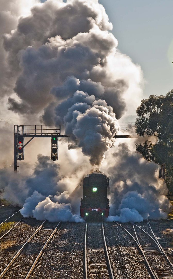

The recently restored AD60 class 4-8-4 + 4-8-4 Beyer Garratt has been undergoing (successful) load testing out of Canberra towards Goulburn this week.
Attached image by Howard Moffat shows the loco leaving Goulburn and heading back to Canberra with the temperature blow freezing yesterday morning.

That engine was really moving along at the 07:15 mark of that video, they weren't babying her (except maybe in the tonnage dept) on that test run.
