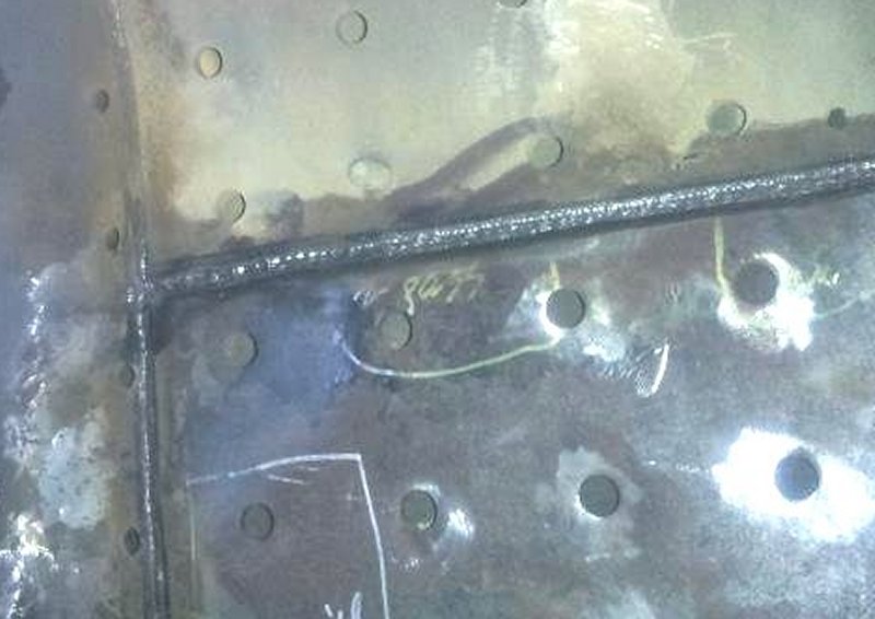

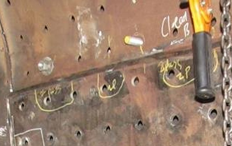

Two that used to be on the BSFS RR website. Apparently the 1-1/2" mis-alignment got fixed before the final welding.

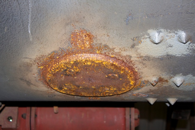

A few days ago this photo showed up showing an 8" wide patch made of flat plate in the radiused corner of the right side. That is an awful lot of rework for a boiler that has never seen a match. I am curious. What broke so bad that caused a flat plate to have to be welded into a round corner?

The silence is deafening. Anybody to comment on the belly scab patch?

I worked on steam some years ago and saw things that were very questionable. A locomotive that I refused to work on was condemned by a boiler inspector and has never had another fire in it since.
I remember Gettysburg, maybe someone should have spoken up sooner about that operation.
I see some thing in the photos that I would question, straight plate in a curved area, small welded on belly patch, spacing of staybolts.
I may not be up to date on the current boiler codes, but people have the right to ask questions.

Is the "flat" an optical illusion? If it is flat, why does the joint at the curved tube sheet look ok?
Belly patch. Location of a discontinued blow down mount?

One must be careful of distortion in photos, especially those taken in close quarters with wide lenses, and that are not too clear to begin with. It does appear as if the side sheet was once not aligned, then was aligned in the photos. The plate at the top of the side going into the crown is definitely somewhat curved at the tube sheet, but looks as if it was straight towards the center. There's no mistaking the not flush fillet welded installation of the plate on the belly, but we don't know if that is reinforcing a flush patch behind it or what the whole story might be. So, we're certainly not able to pass judgement on anything based on hazy images which may not depict real conditions accurately and incomplete information, assuming it is our job to do so in the first place.
Curiosity about techniques and practices is another thing, however....and I like the idea of sharing among us to make us all smarter. I'm certainly interested in the whole story from that perspective.

Are those rivets in the belly patch? Looks like 4 of them.

I see rivets in the patch too.
Also, I don't think the first two photos, about the misalignment, are the same location. As I examine them, I don't see how the second photo could be the first, even with material replacement.

Again, hazy photo, but the "rivets" look more like plug welds to me. In either case, it suggests something else behind the patch.
