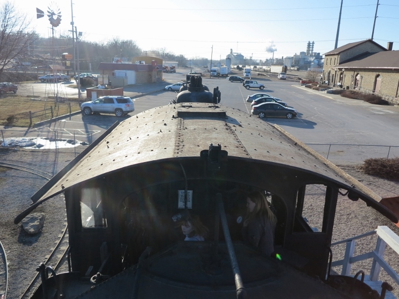

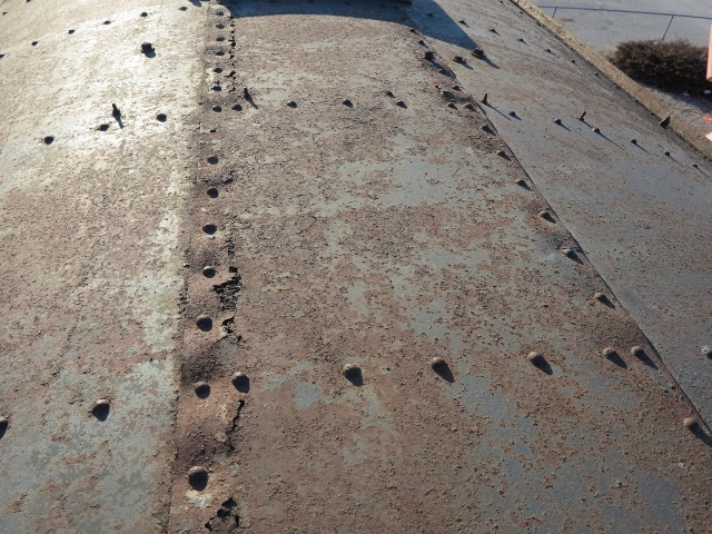

Lets say you have a steam locomotive with a metal cab (including the roof) that has been sitting outside for the past 60 years. The cab roof now not only leaks but has started to rust through in places. The rust through has not affected the structural integrity of the cab roof yet.
There is a desire to perform some cosmetic work on the locomotive (which will remain an outdoor, uncovered display) and the cab roof needs to be sealed to stop the leaks and prevent further damage. While I understand that the correct repair is to replace the rusted through portion of the roof, this is not in the cards now or anytime soon.
Does anyone out there have any suggestions for a solution? A semi long term, low cost fix would be ideal, but I am open to any ideas.
Locomotive is AT&SF 811 in Atchison Kansas.

File comment: ATSF 811 cab roof close up
File comment: ATSF 811 Cab Roof

Regrettably there isn’t a quick fix that will last for any length of time. There is severe corrosion at the lap joint and although you can cover it with all manner of miracle stuff the corrosion with continue to grow. You want to remove the center panel remove the rust and apply a new panel. Also after cleaning the sheet metal, apply a rust conversion coating which chemically alters the iron oxide and serves as a prime for the final finish. There are many out there. Rustoleum make a good one. Elastomeric roof coverings are great. With a small area such as this you could find a remnant from a roofing job usually for free. Be sure to glue the entire surface and not just the edges as is typical in construction. Henry’s is a good product also.
That said, arrest the decay first or you will be wasting time and effort.

Use a torch to heat the areas that have the pack rust, then using either a sledge or preferably a rivet buster with a flat snap, beat the rust out of the seam. Then you can get in there with some sort of rust converter, paint or whatever you choose to coat the seam. Then you can apply the rubberized roofing.

There is no magic goop. Any goop will last for a few years at most and then make the future repairman hate your guts. I have 22,000 square feet of roof that was repeatedly gooped in leaky spots, where it's in the way of any other repair. It is too much to remove, so now our only choice is to replace the roof.
Fiberglass might be an option due to being static. Fiberglass is two things at once: an epoxy coating and fiber structural reinforcement. Since it doesn't appear to need structural strength, the only meaningful part is the coating. The real problem is the rust will continue to bloom unabated underneath the coating. That will be the same for all coatings.
If you have discovered a magic coating which makes rust stop rusting, please tell me as it will end my search. However the last thing I need is more noobs bouncing up to me with a bottle of goop and a fish story from a salesman or a label. Most of those fish stories have a 3 year warranty, at which point they become a liability and impediment to further repair.
Nothing works -not rust converter, not wirebrush, not needle scaling- except media blast to near white metal (SSPC SP10) followed by any of a variety of quality primers. That is held out by NASA and others' very extensive research on the subject.
We have a gondola that lives in Michigan winters. It was media blasted to SP10 and painted with Standard Detroit Paint Co. (defunct)’s non-lead primer ($12/gal at the time) and their topcoat, in 1987. The topcoat lasted 20 years but the primer is still going strong and is slowly being overcoated with Awlgrip 545 2-pack epoxy primer and their G/H topcoat which is LPU. The areas painted in 2010 cannot be distinguished from the areas painted in 2014.
The gon also had new metalwork which had rusted. This was wirebrushed, "quality" rust converter, 545 and G/H topcoat in 2009. It failed by 2013.
In your case it looks like the center sheet is taking the brunt of the rust. I would drill out the rivets, remove it, replace it with steel or a composite material. I would not throw EPDM over it since the roof is all steel and provides no convenient holes or mounts to affix the EPDM around the edges. I would certainly not glue any roofing material down to rusty steel unless your aim is to make rust for a future thermite project.
