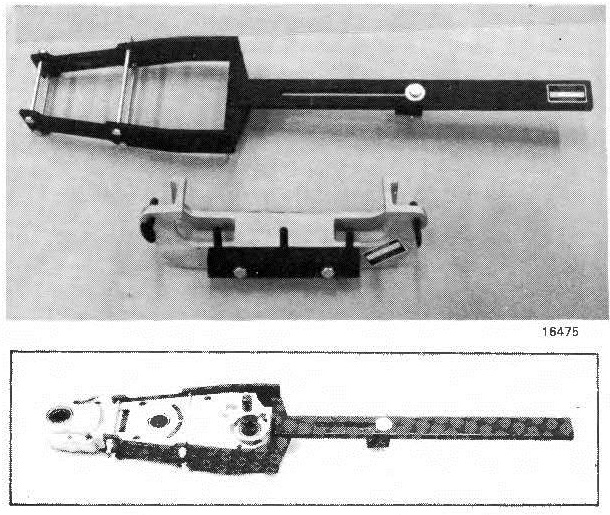

We are in need of a reaction arm and cradle assembly to tighten EMD 567B main bearing caps. We have the torque multiplier for 567Cs, which is used with the reaction arm to do the 567Bs. Any leads would be greatly appreciated. This would be used by the staff at Steamtown National Historic Site to replace the thrust bearings in F3 663.

The adapter kit Mike is looking for is EMD part number 8437890.
picture of the adapter(s) we are looking for, we have the torque multiplier as it is the same one we use on our C block EMD.

Each of the builders (Alco, BLW, EMD, GE, LH) issued a catalog of special tooling for their particular locomotives. Some of the more inventive railroad shops were able to 'homebrew' some of the less specialized items.
In the case of devices involving the application of a large torque to an engine assembly, irrespective of the builder, the basis of the tool was standard (and some specialized) items supplied by the Sweeney Tool Company.
Mikes' photo shows a Sweeney torque multiplier, along with a cast aluminum device (also made by Sweeney) that restrains the device within EMD the crankcase inspection port. The reaction arm may have been made by EMD back when the mfg. activity @ LaGrange was more diverse in scope.
Today, these human powered devices have been supplanted by pneumatic or hydraulic devices that allow for more consistency in application, pose less of an injury hazard and allow for greater productivity.

Posts: 2133
Nick, the 567 engines from the start of production through the 567B used rectangular handhole covers on the engine oil pan and air box. Starting with 567C production the crankcase was extensively redesigned with round handhole covers to improve the strength of the structure and provide for equal loading of the gasket all the way around the cover.
The reaction cradle and mount bracket are used to anchor the free end of the Sweeney torque multiplier when using the tool on main bearing stud nuts. For the early engines through the 567B the bracket which mounts to the oil pan is designed to seat securely in the contour and dimensions of a rectangular handhole cover.
There is a tremendous amount of force involved in major fastenings in large diesel engines and consequently having the tool anchored correctly at the proper angle and geometry for the job being done is an important safety concern. I have seen instances where sockets shattered when force was applied without them being completely and correctly seated, resulting in debris being thrown with considerable force. I have also seen instances where fastenings with previously undetected fatigue cracks fractured suddenly when being torqued, throwing the torque multiplier off the stud or bolt.
The BC conversion, when an engine is so equipped, makes no change in the main bearing cap stud arrangement so the use of the tool is identical for a 567B or a 567BC.
