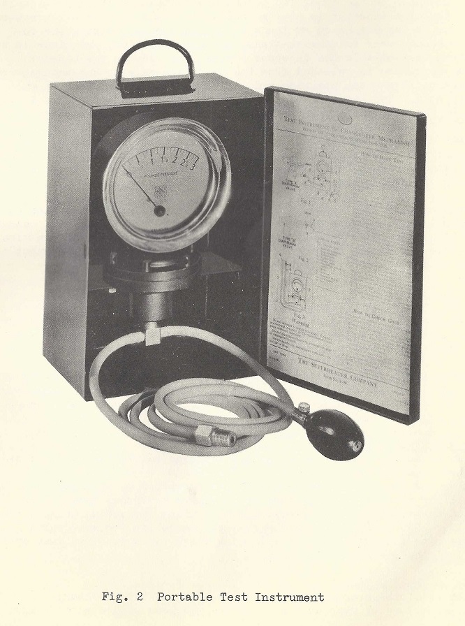

I recently acquired an Ashcroft, German-style, diaphragm gauge that is installed in a metal box. When I received it, I discovered that the well-worn label in the cover of the box described it as a “Test Instrument or Changeover Device of Elesco Exhaust Steam Injectors.” I then located a reasonably priced copy of the instruction manual for the device at an on-line bookseller. After ordering the book, I received a note saying that it had been lost, and refunding my money. There is another copy available, but it is priced at much more than what I paid for the gauge.
Does anyone here have a simple explanation of how this device was used?

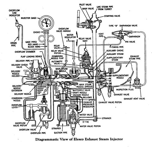

While an engine is hot, you could connect this device to substitute for exhaust steam to operate the diaphragm which controls the pin valve.
File comment: Changeover Description
File comment: Diagrammatic View

See attached pictures for the description of how and why this test instrument was used on the Elesco exhaust steam injectors. It's main purpose was to test the diaphragm valve. The pictures are from the Elesco operation and service instructions for Type T Injectors, Bulletin 5700-4, dated June 1941. The test instrument has it's own separate bulletin, which I also have. PM me if you want the pdf files.
UP's 3985 and 4014 utilize the Elesco TP exhaust injector system. You can see the exhaust injector under the running board on the fireman's side of the smokebox.
Hope that helps,
Joe
