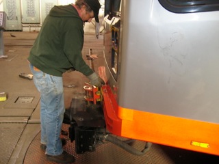

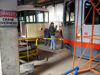

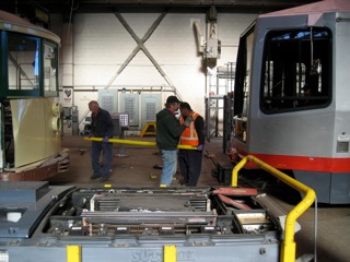

Good Morning,
Typically older streetcars do not have (as mentioned previous) automatic couplers, although many cities did have these as well.
Attached are a couple photos showing the art of coupling (in this case, uncoupling) with a tow bar. This was taken in ideal conditions, the cars were indoors, good lighting, ect.. Imagine doing this in the rain, it's dark out, there is just you and the operator, maybe there is a grade involved. Also, note the modern Light Rail Car does have an automatic coupler as well, but the older one does not.
Not knowing any of what happened at the museum in Minneapolis, these photos may not be of any value, but does show how it works for those unfamiliar with the procedure.
And as mentioned, I do hope the injured party recovers fully.
Karl Johnson

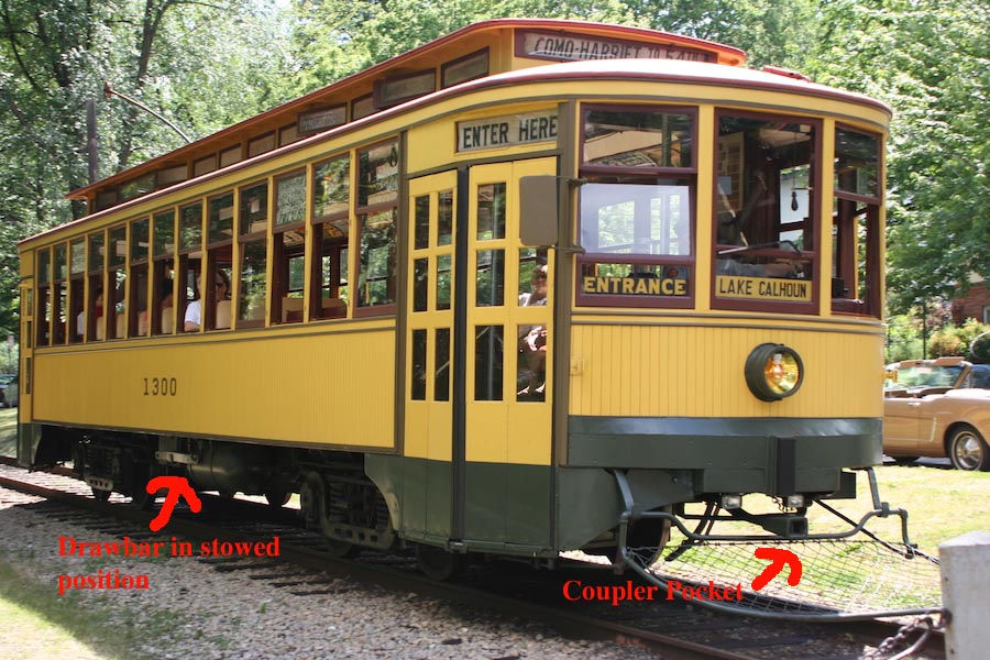

Posts: 548
photo of TCRT 1300
