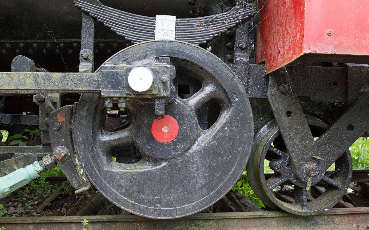

I recently photographed this Porter 0-4-0 at Cool Springs Park, a roadside attraction near Rowlesburg, West Virginia. I have no information on it, and could find no indications of its heritage.
The Porter appears to be a close-clearance design with a home-built cab, and is 42” gauge. However, someone has modified the engine to run on 36” gauge track. The drivers on the right side of the locomotive touch the rails, while those on left side are suspended by guide wheels that have been bolted to the frame. Very strange, to say the least. It is NOT a compressed air locomotive – note the smokebox and the firebox in the cab.
The engine is possibly Three Forks – Sewel Coal. I do not have a copy of the Porter book to check if the Three Forks Coal Company rostered any close-clearance Porters.

This "re-gauged" locomotive is really interesting. Brings up some questions:
1. How would you figure T.E. (tractive effort)? Having only one set of drivers on the rails would lower the T.E., or would it?
2. Would this revision make the 0-4-0 a 2-4-2?
3. Was this re-gauging done by a previous owner so that the locomotive could actually be used as motive power, or strictly at the Cool Springs Park to run around on their track (assuming they had some)?
4. If such an arrangement COULD provide enough tractive effort to move cars around, was this ever actually done by any company in the steam era?
Thanks.

Les, I'd say she's an 0-2-0T.

Maybe an 0-1+2+1-0T, or a 1/2-2-1/2T.... thought I'd seen everything.

An engineering and design marvel --- engine weight on the crown brasses on the right side, on the fireman's side it's on the idlers with the drivers spinning on the grease cellars !!! It doesn't look like the idlers have any kind of bearings to speak of, either. Tractive effort would be cut in half because the weight on drivers is cut in half, sort of...
And we've been thinking there were only EIGHT wonders of the world.
Sammy -
Of course, we're assuming that the thing actually ran in this configuration! Be really interesting to know if she actually DID!

I think she would run, but for how long ??? Don't know if she'd stay on the track, though, the idlers don't look to be sprung, seems like that might have consequences...

Based on inexpert SWAG, I'd say the TE on this booger is still the same (TE calculations do not depend on the number of drivers).
But with only half the weight on the two drivers, it has a very poor adhesion (slippery).

You're right of course, TE is the same, but the FA is half as much. That teakettle is crippled by any formula you can figure. I think we all agree she MIGHT pull half as much as she did in the first place, if nothing malfunctioned too bad.
