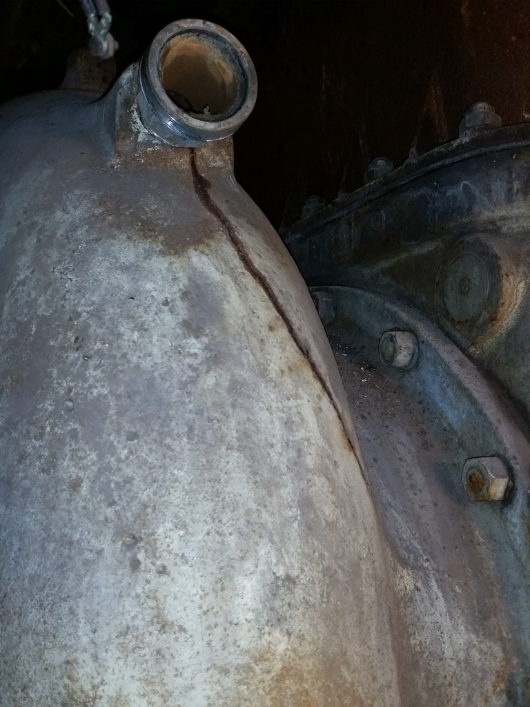

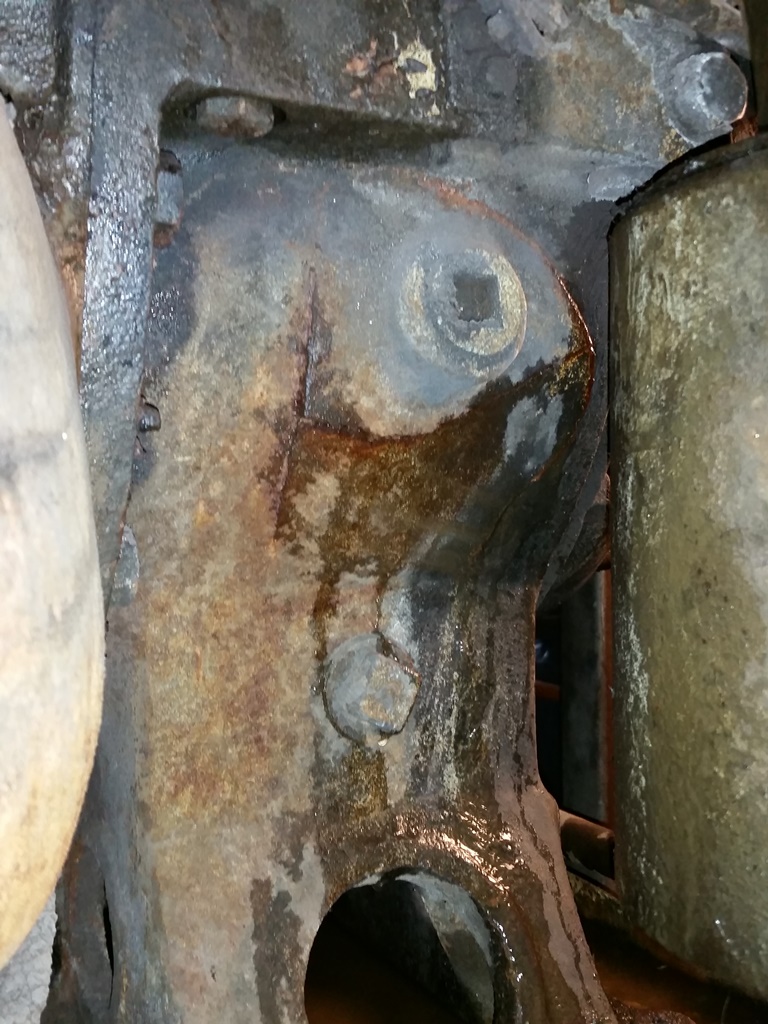

Bucci turbo on McDonald Steel S2 777. Two big freeze damaged areas, one part cracked in an H pattern, the other split along the outside of the housing near the top. Since replacement turbos are a bit hard to find, I'm going to have to try to repair these areas.
See that pipe plug at the bottom of the first photo. That is where a GURU plug is going to be going, and about five more of them will go on this locomotive!

I suggest you investigate a product known as "Lock-N-Stitch" (tm). I have had success with it repairing internal cracks in cast iron castings. There are similar products on the market.
Do not waste your time trying to weld those cracks, it is as close to impossible as you will ever want to get. And it is not a matter of your skills. Basically when you weld a cast iron piece like that the stress from temperature induced expansion exceeds the strength of the cast iron. The welding process just moves the cracks around, or hides them for a few months.
I know a fellow that had similar freeze damage to an Alco turbo, after attempting a welded repair (from an "expert" cast iron welder), he ended up getting a replacement turbo.
And no, I do not work for, or have any financial interest in the "Lock-N-Stick" company, but their stuff does work.
Good Luck, KevinK.

I was recommended to look into a product called belzona, an industrial repair epoxy. I also know about locknstitch, I have a sample of their stitching pins in my desk drawer. I may end up using a combination of the two on this repair.

Rick, yes there are other products out there.
The "Lock-N-Stitch" folks have some good tutorials on their website, and a wide variety of sizes.
I used their products to "stitch" a crack right across an intake valve seat on a 1920's Buda gasoline engine. Worked great.
I am not opposed to epoxy as a repair material for some situations, but I do not believe that it has any real strength to "pull" the crack together, it mostly acts to "fill" the crack and does not restore the original strength of the cast metal. The stitching pins actually "pull" the cracked metal together.
If it was my Turbo I would be inclined to use the "Lock-N-Stitch" products. But using the stitching pins probably requires a "tear down" and reassembly process (so you can clean up all the chips from the stitching process). If you just want to seal some leaks for a few years an epoxy will work (for a few years).
The thing about cracks is that they will just keep getting longer unless you relieve the stress at the end of the crack. I work with large glass mirrors and when a crack appears we often drill a hole slightly past the end of the crack to relieve the stress and then fill the crack with an epoxy like material. The stitching pins actually pull the crack back together and relieve the stress and stop (for a long time) the crack from progressing.
Good Luck, KevinK.

For that turbo to crack that high, it would appear that the engine was full of water. It is not uncommon for them to crack at the lower spot where it cracked.
Before wasting time and money trying to repair those cracks or replace the turbo, you better check for other cracks. As high as that crack is, I would say that the heads are cracked as well. Their weakest point is between the valves.
If the turbo is all the cracking you have, I know where there is a very good Bushi turbo.

At Texas State RR, we used Belzona when nothing else would work, such as small cracks in steam locomotive cylinder blocks. Sometimes it worked, and sometimes it held. But, I don't know about a turbo, I guess you could try it before you tried something more drastic.

"I know a guy" who had almost identical freeze damage to a Buchi turbo. A couple of things to consider:
1) Even if you are successful in repairing the visible cracks (an unlikely prospect, at best), there are interior walls to the water jacket that suffered equal forces to the exterior walls. We found that after extensive (and expensive) attempts at repair, there was additional damage, inside the turbo, that was not visible. When we put water back in the repaired one, it ran out the oil lines.
The illustrated turbo is (probably) scrap. Disassemble it, and save the rotor. They have value. I have not shopped for 539 parts recently, but they're out there. And people are scrapping Alcos all the time. It might take a little time, but you'll find a turbo.
2) Freeze damage to the turbo does not necessarily indicate freeze damage to the block. On the 539, draining the water from the turbo is a separate, independent step, from draining the block. It is entirely possible that the last owner correctly drained the block, but failed to do so, with the turbo. Don't give up hope on the block, until it's been thoroughly checked out.
JR

I found the turbo cracks when I filled the locomotive with water, checking intently for any water to appear trickling down into the sump from any block cracks. There was none. There is a 5" radiator hose at the free end of the engine that upon my first attempt to fill leaked water from the lower joint. I surmise that the loco had this leak when it was last operated, and slowly leaked water out of the system down to that level. This brought the water level under the block level and most likely saved it from freezing. The turbo itself does not drain on its own without opening a drain cock under it.
When I found the turbo cracks I removed the oil drain lines looking for water in the oil passages and found none.
I do have another turbo of a completely different style on our parts S2, but its been sitting without a cap on the stack for 30 years and is 1/3 full of water, so its usefulness is rather doubtful.
