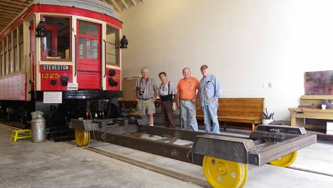

Yes, the FVHRS will be using a towed/pushed generator. The fine folks in Astoria gave us a set of plans for their cart and we had them modified to fit a larger genset. Wheel sets were from Noland.
Attached picture just shows the cart. It will go to Cummins in mid Sept. to have the genset attached. A rectifier will be included to change the AC to DC.
Just today we did a series of tests to see how it would go through switches. Passed. We will do some more once the completed cart returns.

I am skittish of generator carts, especially over less-than-pristine rail, or reused freight railroad. I've done a lot of handling lightweight cars over regular railroad, and the combined experience of NARCOA is considerable. There's a higher risk of derailment simply because they are lightweight cars. They are more sensitive to track conditions and more likely to pick switches. Carts generally have more rigid suspensions and so are more subject to surfacing problems, resonance, etc. With no one on board the cart, you have no way of detecting these things. They tend to have "compromise" (not full width, not full flange) wheels, and that makes them more likely to discover wide gage and pick frogs. I'm generalizing, but this much is for sure: if the cart derails pulling it, that's merely embarrassing. If pushing, however, it can create a real mess.
