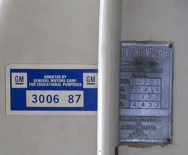

I'm going to give you a little nitpick just for fun as it's an excuse to post these photos. This is the only Winton 201 known to exist. It's one of the two prototypes that were used on the demo Chevy assembly line at the Chicago World's Fair in 1933 (another V type went to the US Navy). This was one of the engines seen by the president of the Burlington and was thus selected to power the planned Zephyr train.
The catch of course is that these prototypes were Model 201. The production model, which of course is what you really mean, was Model 201A.
This engine is displayed at Illinois Railway Museum.
Steve

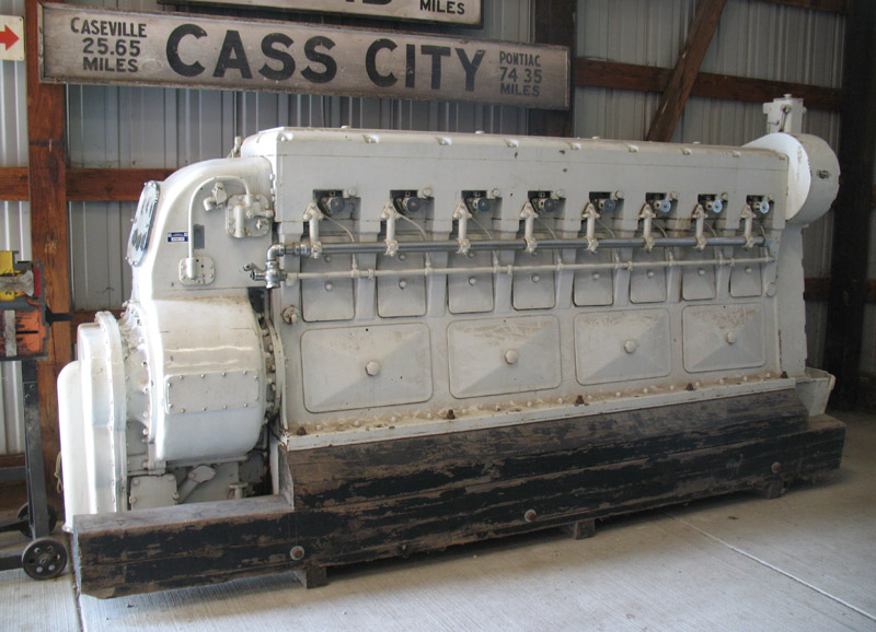

For the sake of accuracy let me note that the 201A engine that is on open display in the coach shop area of the B&O museum is an eight cylinder, rather than a twelve cylinder as was originally in the linked article on Utah Rails and RYPN. (Text was edited on Utah Rails). It was the spare engine from the Canton Railroad's Winton powered switchers, and is probably in the best condition of all the Winton 201A engines that are preserved, but it is not in a locomotive.
CSRM and IRM each have 12-201A engines that are not in locomotives. Both were originally at CSRM, acquired from a scrapper.
