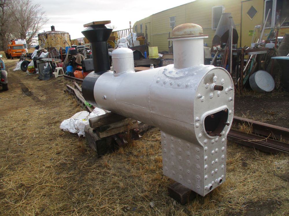

I saw photos of the Kepner collection on Facebook. We all have seen some photos, so nothing much new.
However, I did see this boiler. I know nothing about it, but just think whomever ended up with it needs to know it is not properly designed, and probably should not be fired.

Is it because of the unsupported flat sidewalls in the wagontop end?

The tapered course and "wagon top" sides of the firebox are flat, unsupported areas (at least from what I think I see in this photo).
As Kelly mentioned, a hydrostatic test may cause deformation in these areas.

I'm not too crazy about the outer corners on the backhead. When it's pressured up, these are always under tension, creating stress risers. "Buyer beware"... There also looks to be a horizontal seam running across those unsupported areas on the side sheets.

So I'm really confused by this. Much of it looks like a BBQ, but there's also enough stuff on there that look somewhat legit to make me wonder if somebody actually built this as a boiler?
Obviously Mark's right, this is lawn art. But I'm curious about what appear to be staybolts on that bottom potion. Ignoring the whole "I don't think the Form 4 is gonna pencil out", how would that even work at all. You've got one, then right beside on a 90 degree corner, you have another. How can that even be built? The whole row is that way. Are they even real, or is it all decorations?

Not sure how one can say it’s a “bad boiler” just from a couple of photos. Is it odd? Yes. But it does have a NB stamp on it. Built by the GABCO B&E Company in 1967. Looks like it was built for a 15” gauge locomotive.

If anybody wants to make a little wager, I'd bet that BSO couldn't get a legitimate code stamp TODAY.
