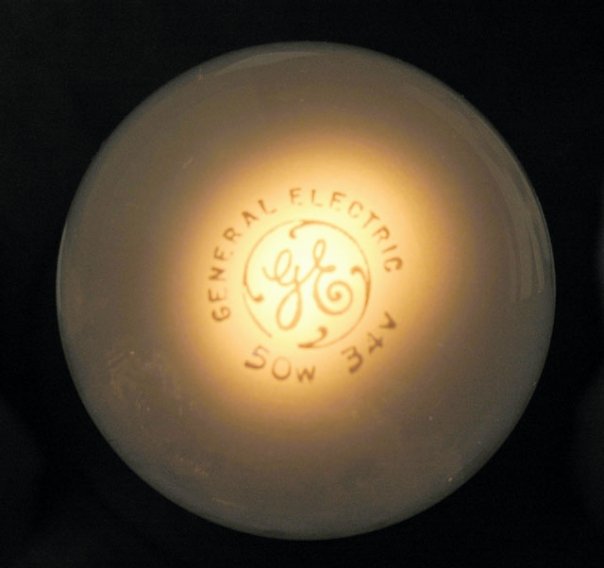

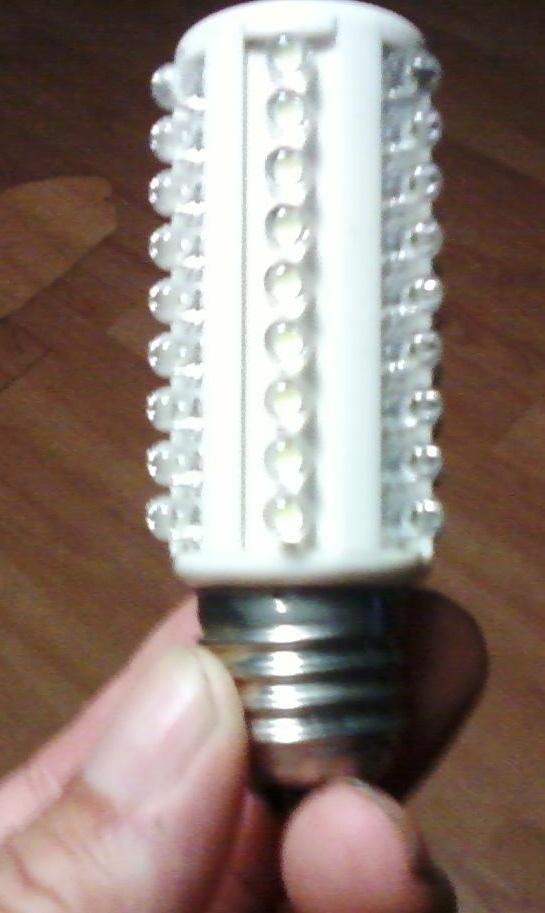

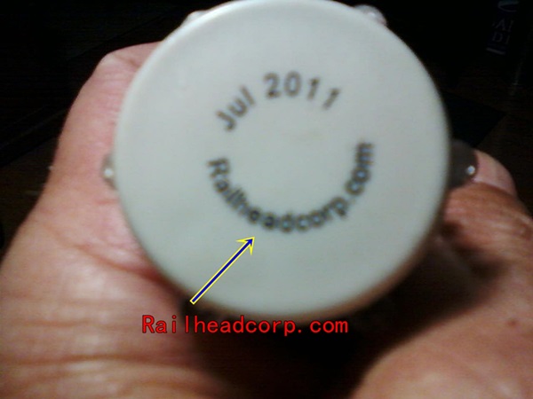

The LED bulbs that railroads use... they will illuminate on voltage from 24 up to 74 VAC or VDC... either one. This is one whose light spreads out horizontally.. for number boards and at floor level use normally...
I quit testing at 74volts. I've plugged them into 115vac... they blink on, then extinguish. Doesn't do any damage...
Light output is bright no matter what the voltage... they don't dim down at 24. They draw very little current.
I run some on a 24vac doorbell transformer.... about 20 of them on one transformer right now.
I have no doubt they are expensive. An acquaintance of mine got a whole case of them from a source... and has put them up all over his shop.
I gave him a 74vac Tx from an old RR radio base station and he's wired all of them to it.
You can just run lite gauge speaker wire to them... low current draw and low voltage, too.
