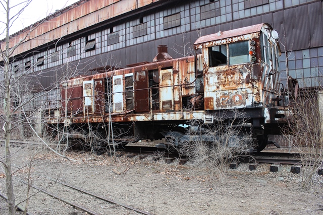

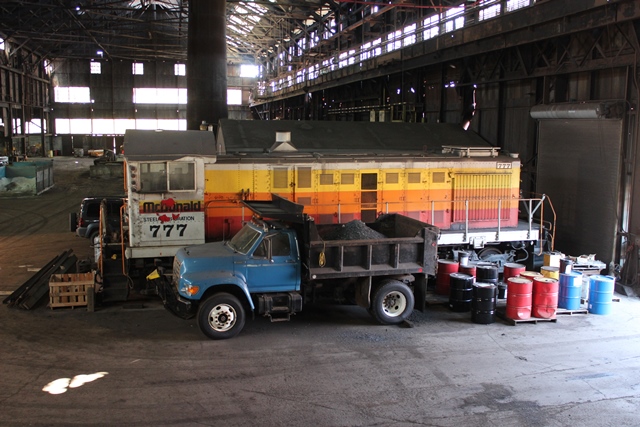

The four Alcos, 70-73 worked at the plant until the Ohio Works was shut down in 1980. In 1981 a group of investors reopened a portion of the McDonald Works operating two of the rolling mills, and included in the deal were Alcos 70 and 73. The 73 was operable and became the plant switcher, while the 70 was retained solely as a parts source for the 73. 73 was renumbered 777, painted in a yellow,orange and red scheme and housed inside the mill building when not being used. 70 was parked on a siding in between two buildings and largely forgotten about.
McDonald Stopped using the 777 several years ago and instead bought a trackmobile, which is much easier on the sharp curves inside the plant. But because the company's founder was a railfan, nobody had the heart to get rid of the 777 o it was simply left to sit on her siding.

So, as of today Youngstown Steel Heritage has taken ownership of both of these locomotives, with plans to preserve both. 777 will be going with the 80 tonner, (G&W 20) to the Lake Shore Railway Museum for temporary exhibit, and the 70 will be stabilized, repainted and left on its siding until we figure out what to do with it. 70 will never run again but may make a nice static display somewhere, but the 777 will be running again within a few weeks. It will forever retain its McDonald Steel paint scheme and will be dedicated to David Houck, founder and fist president.

I just found these photos of the two Alcos taken on the same day in 1982.

We are borrowing the set of unitized batteries out of the B39-8 at the Lake Shore Railway Museum to replace the failed batteries in the 777. Brought one battery back yesterday. At 1,700 lbs. each it was a healthy load for my F250.
Tuesday will be a day long work session on the 777 as we start to clean it up and check its condition. Probably a couple of weeks away from trying to start the locomotive, if everything checks out.
 Post subject: Re: Ohio Works Alco S2s
PostPosted: Wed May 06, 2015 7:38 am
Went to fill the cooling system with water yesterday. Had to repair freeze damage first. Cracked shutoff valve to cab heater, cracked elbow in branch line to heater, cracked Kim Hotstart. Got all of those fixed or isolated then water started coming out of two holes in the bottom of the radiator header. I think I can temporarily patch both holes enough to get it filled and running, but the header will have to eventually come out to be rebuilt.

I'm not sure that the bottom manifold on 70 is any better. It may be, since it has not operated since 1982 and has about 20 fewer years of use. Changing it out will take about three days. If the patches hold and I can get it running initially, I'll then change out the manifolds for the permanent repair. I hate to spend all that time doing the repair now only to find a much larger problem that would sideline the locomotive.
