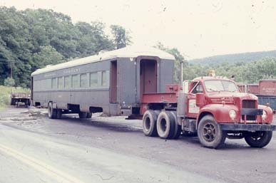

How it got to Hegins, PA, would you try this method today? Unknown photographer 1972

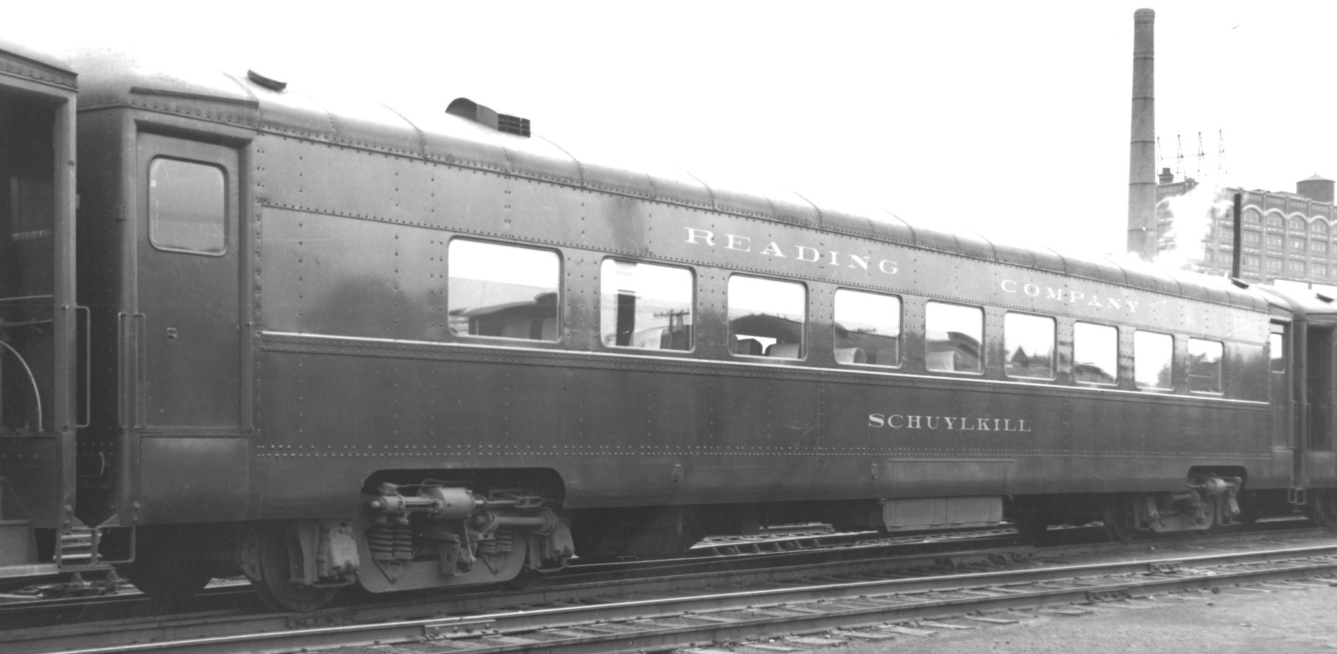

I believe this is a Reading Company photo of the car in service.

The trucks under those Reading cars appear to be 9" narrow pedestal 5.5x10 trucks - similar to the B&O "Royal Blue" cars.
Long Island ISH 5.5x10 would be the closest type/style. No reason to waste a 6x11 set under too light a car.

Reminds me of the trucks under the NS exhibit car. Some of the pre-war heavyweights had an 11" +/- pedestal opening for 6x11 journals and based on the picture that may well be what's going on with these Reading cars. I bet there is a retrofit that would work. Some info on the center plate would help, as well as knowing the weight of the car.
And doing a little gentle nit picking, if they're 6x11 then it should be 41-N-11 not 41-N.
