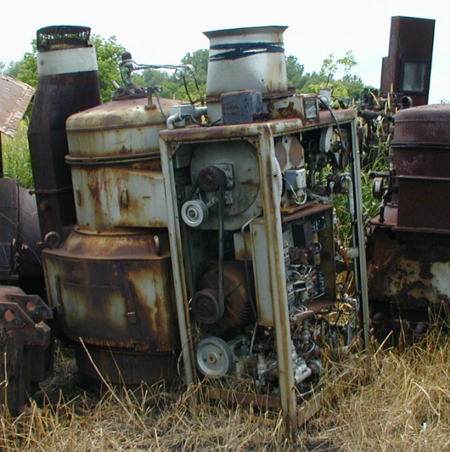

I most certainly do not speak for Illinois Railway Museum but I seem to recall a few sitting around rusting away so you might want to get in touch. The photo is from July 2000.
 Post subject: Re: Anyone know of any Steam Generators?
PostPosted: Sat May 16, 2015 9:28 pm
Posts: 841
4625 is a relatively small unit. Those look more like 4740s.

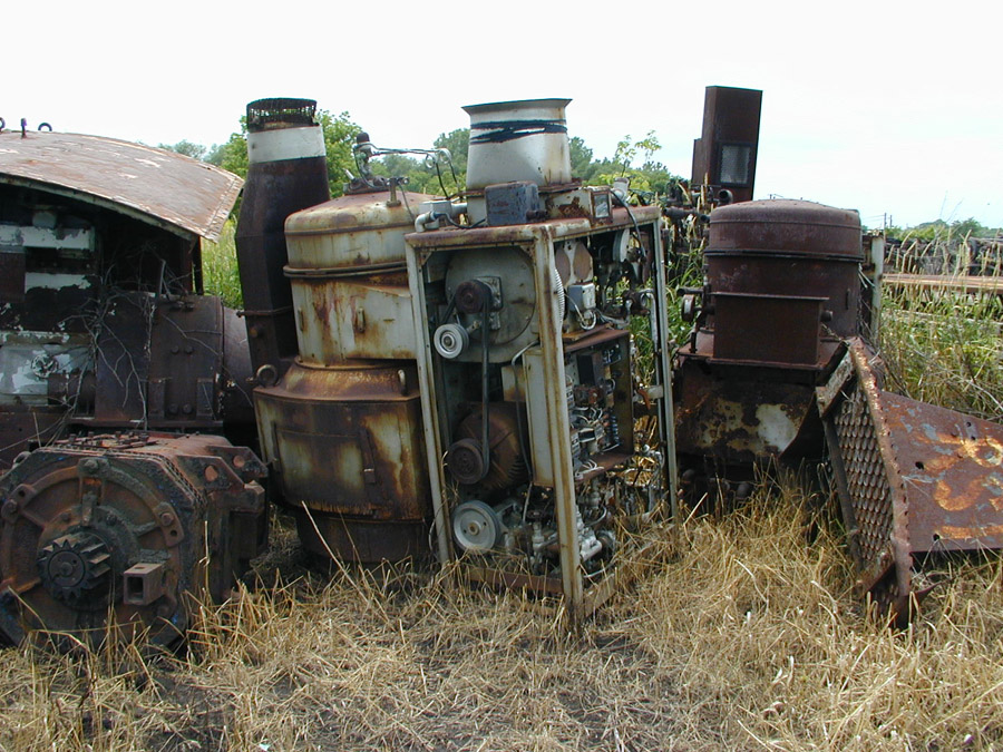

I am only an associate member there so I don't think that qualifies me as "from IRM" but I can assure you that the photo I posted was taken by me there on July 4, 2000. Next time I visit I will look to see if they are still there. (Would have gone today but the weather was iffy.) Why not simply contact them and ask if they have any they'd be willing to part with?
In the meantime here is the full view of the same image.
